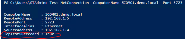

    Please first ensure that the ports are still open towards the Gateway or Management Server. This you can do by running a simple PowerShell command on your workgroup agents:
    Test-NetConnection -ComputerName <FQDN of your Gateway or Management Server> -Port 5723
    The output should look like this:
    If this is OK, you can now move to the certificates.

    So, you can just copy paste this and the run it on your workgroup agent (PowerShell console as Admin) . The script goes though all the certificates in the Computer store, so you might see more then one result. But... The result for the SCOM certificates should be fully green (all rows from the output should be green). This means that all certificate properties are OK. If this is not the case (if there is a red row regarding the SCOM certificate) , you need to address the issue.
    As mentioned the script checks all certificates, so you need to identify the correct output, using the certial number of the certificate.
    Here is an example of one certificate being checked:
    As you see some checks are red, some yellow...This is because I have a certificarte, which is for soemthing else (not SCOM related). In you case, all the checks should come green. If this is not the case, please post here which checks are failing and I will try to help you out.
    P.S. The script is hard to find nowdays, but is a super tool to check your SCOM certificates in a quick manner.
    Important:
    Because cetificate based authentication always happens on both sides, you need to ensure that the certificates on the Gateway or Management Server that the agents reports to, are also correct.
    You can just run the script on your Gateway or Management Server(s) and examine the output. It should be fully green on both sides.
    Please post here the ouput if it different from green only, I will try to help your regarding the failed checks.
    This is a good start, let's see where this gets us,
    Cheers,
