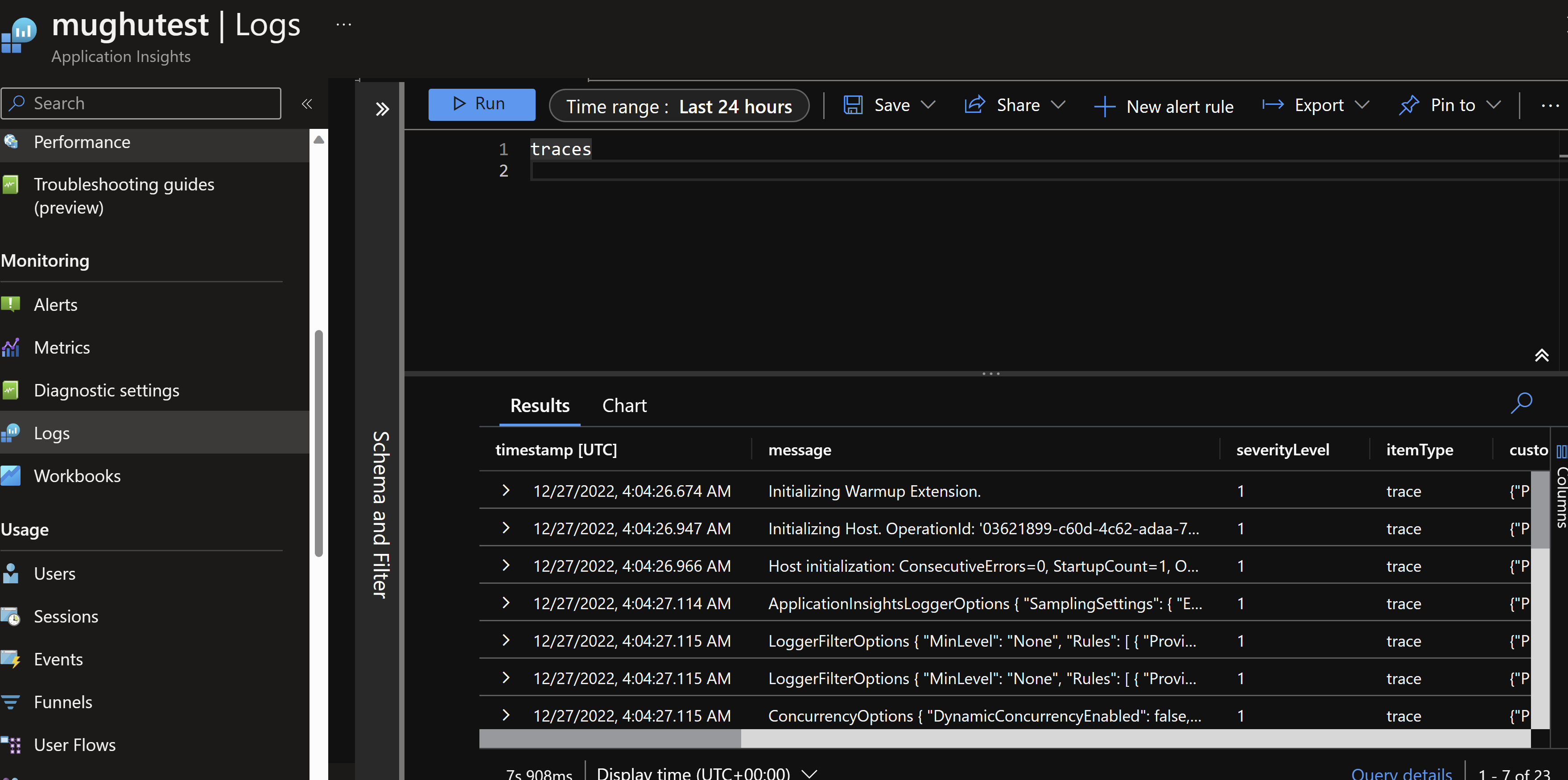

    It appears that you have done quite some research before reaching out to this forum. You have already checked a lot of details, only step that is missing is to check if the Function host was down due to some reason between 14:45 and 17:30 UTC. I would suggest you check the Traces logs in the Application insights logs section to see if there are any issues related to function host. The timer trigger would be pastdue if the scheduled invocation was missed due to a reason which is mostly the function host being down or restarted. So please check the traces logs to get more insights.
