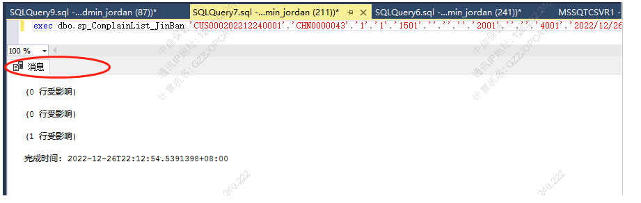

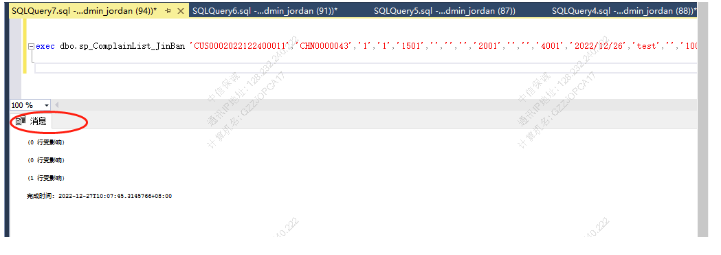

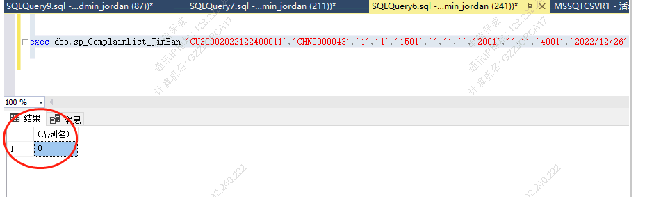

sqlserver 2005 single instance:
sqlserver 2016 single instance:
sqlserver 2016 alwayson:
This difference leads to alwayson execution when use jdbc driver:

  1. Bjoern Peters 8,921 Reputation points
    2022-12-28T14:27:28.777+00:00
    Hi @jiajun su
    make sure the configuration for each session in SSMS is the same and please post the same screenshot for the last result (2016 AO) with active tab on the text results...
    Are you 100% sure that all data on all machines is the same?
    What about database compat level on those three databases? Are they the same?
    That screenshot of 2016 AO doesn't mean that there are more results, it just shows you a resultset as a grid... as Yitzhak already stated, we need to see your DDL for the proc to understand the output... your results on 2005 and 2016 seems to be the same (0,0,1)... so there is at least one row as a result... and maybe it is just a difference in the optical view in SSMS and the text output says the same as on the other instances...

  2. Erland Sommarskog 121.4K Reputation points MVP Volunteer Moderator
    2022-12-28T22:24:28.157+00:00
    Obvious possible reasons for the differences:
    1) Different code in the different databases.
    2) Different data in the different databases.
    The fact that one database is in an availability group as such has nothing to do with it. Although, hypothetically, the SP may be coded in such a way that it produces a result set if you are in an AG. But the reason for the unexpected result set is likely to be something else, for instance a stray debug SELECT. You will need to look at the code.
    You real problem seems to be the failing Java code, and the error message is very clear:
    java.sql.SQLException: Output parameters have not yet been processed. Call getMoreResults().
    And that is exactly what you need. Whatever API you are using, you should always ask to get the next result set until you get a negative answer. You should never make an assumption that you only have a certain number of result set. Not only because you can get error because of unexpected SELECT, but you can also miss exceptions from the SQL code this way.
