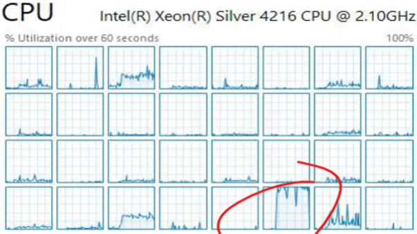

    Thanks for your help on this. So we have carried out some testing and there is a very large routine that when we run on the old server (Intel(R) Xeon(R) CPU E3-1220 v6 @ 3.00GHz 4 x Cores) using SQL EXPRESS the process takes 24 mins, however if I run the same process on the new server (Intel(R) Xeon(R) Silver 4216 CPU @ 2.10GHz) using SQL STANDARD then it takes 56 mins.
    My logic is that with SQL STANDARD being licenced for 24 cores vs EXPRESS 4 cores then surely the new server would be quicker as it is using more cores albeit the core being slower?
    When I run a query on STANDARD on the new server, I still only see one logical processor working. Is this expected behaviour?

  5. Bruce (SqlWork.com) 82,061 Reputation points Volunteer Moderator
    2023-01-23T22:43:33.5466667+00:00
    with your sql query, you will not see difference between standard & express as far as cpu.
    standard should use more memory. but this may be little help on a single query as they both need to read the same pages. standard may be faster on a second query, but depends on cache reuse
    again unless forced to parallel plan a single core is used for the query. see:
