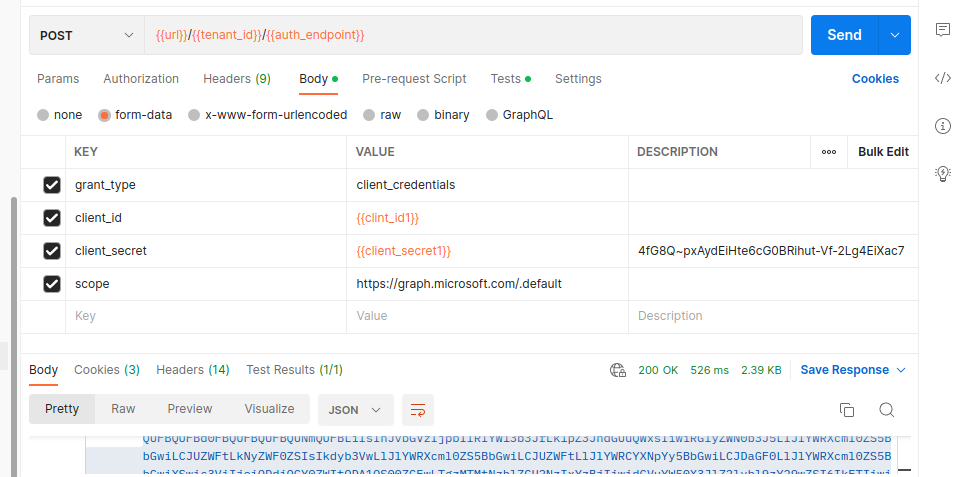

Send messages in Channel APIs we have added the Application permission even if added application permission we are unable send message in channel we are getting 401 Unauthorized response
Abdul Shuaib 36 Reputation points
2023-01-06T13:51:25.137+00:00
Application permission added these for this below api call:- Application permission (Teamwork.Migrate.All ,Chat.Send) is not availabe in our application permission account
send messages url:- https://graph.microsoft.com/v1.0/teams/{{team_id}}/channels/{{channel_id}}/messages

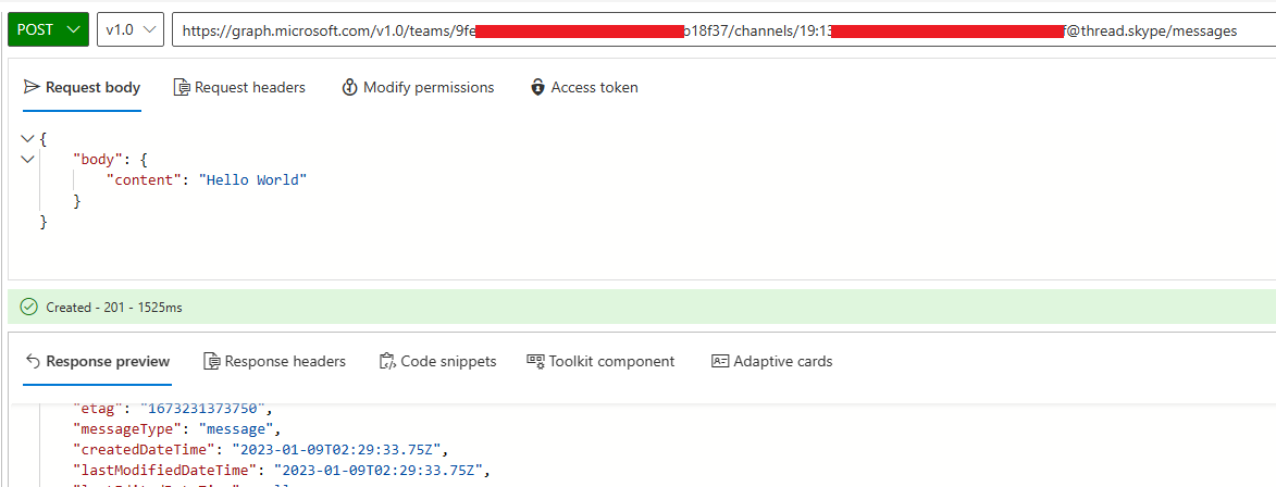

    Hi @Abdul Shuaib

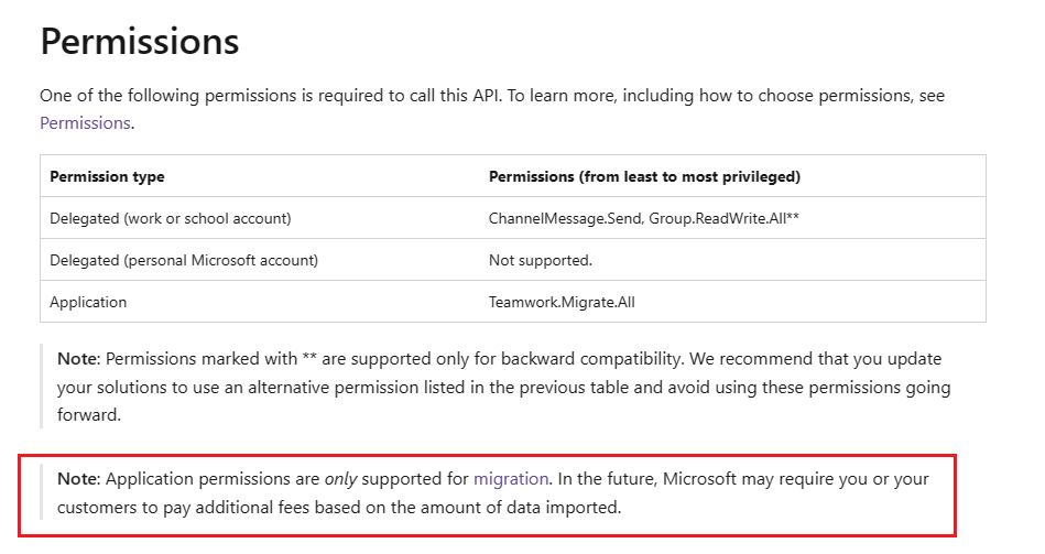

    You are getting this error because of Application permissions. As per the documentation, Application permissions are only supported for migration.
    Otherwise, this API does not support Application permissions.

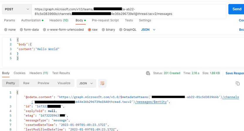

    In case: your team is not in migration you need to use delegated permissions and I have tried this Graph API using delegated permissions, its working as expected. Please refer to the below sample screenshot
    Hope this helps.

  1. CarlZhao-MSFT 46,376 Reputation points
    2023-01-09T02:16:18.09+00:00
    Hi @Abdul Shuaib
    As the documentation says, application permissions are only supported for migration. This means that your team and channel must both be created in a migrated state, otherwise you can only send chat messages in a delegated context.
    Call this api endpoint in graph explorer:

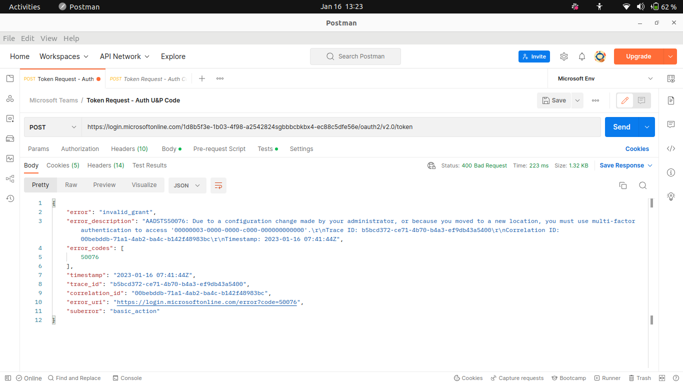

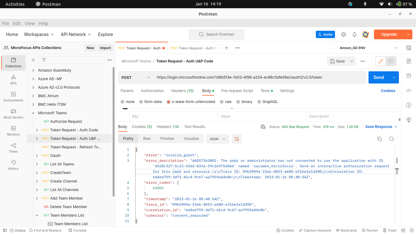

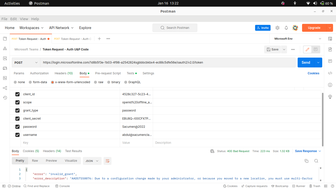

    for send messages in channel endpoint as you suggested above comment auth code flow one I was tried that mechanism was not supported our platform and our higher authority disagree this flow
    second one I have tried ROPC flow here I am getting error while access access token you could refer below snipshot image
    auth_body_param
    above params I was passed as per documentation.
    after sending request I was got these below respone
    ROPC_auth_response
