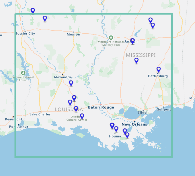

    1. Using topLeft&topRight params only
    https://atlas.microsoft.com/search/fuzzy/json?subscription-key=SUBSCRIPTION_KEY&api-version=1.0&query=123+Main&idxSet=Addr,PAD,POI,XStr&limit=20&typeahead=true&topLeft=33.019457,-94.043147&btmRight=28.928609,-88.817017
    Gives result:
    Selection_468

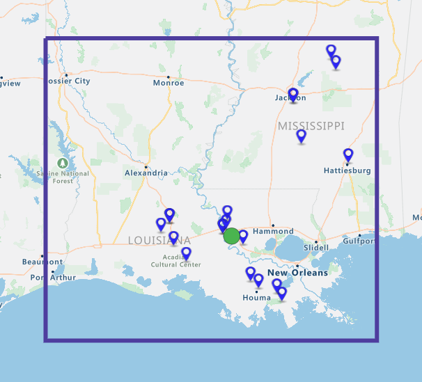

    1. Using both topLeft&topRight params and lat&lon params:
    https://atlas.microsoft.com/search/fuzzy/json?subscription-key=SUBSCRIPTION_KEY&api-version=1.0&query=123+Main&idxSet=Addr,PAD,POI,XStr&limit=20&typeahead=true&topLeft=33.019457,-94.043147&btmRight=28.928609,-88.817017&lat=30.3618&lon=-91.1067
    Selection_470
    Notes:
    1. The countrySet param has not been used in either of these examples yet the result are what you'd expect. This param is now only really required if you have a usecase where you need a further filter so that, for example, you only want to return results on one side of a national border even though the view covers more than one country.
    2. The lat lon bias (green marker) now works with the bounding box params.
