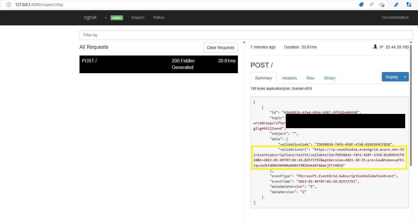

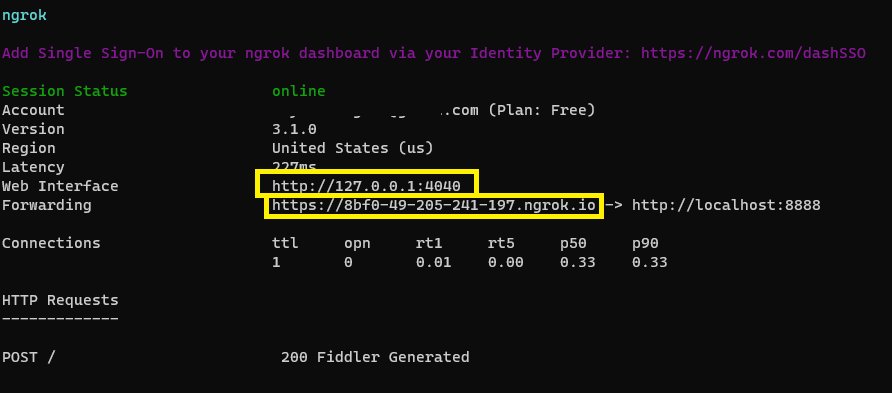

    Once I have started ngrok you can see the web interface and forwarding. The forwarding endpoint (over the internet) will be your webhook endpoint that you will be configuring while creating the event grid subscription. In the web interface you will see the validation code and URL as below.
    Get the validationUrl and open the URL in your browser so the validation of endpoint is sucessfull.
    Successfully Validating the endpoint:
