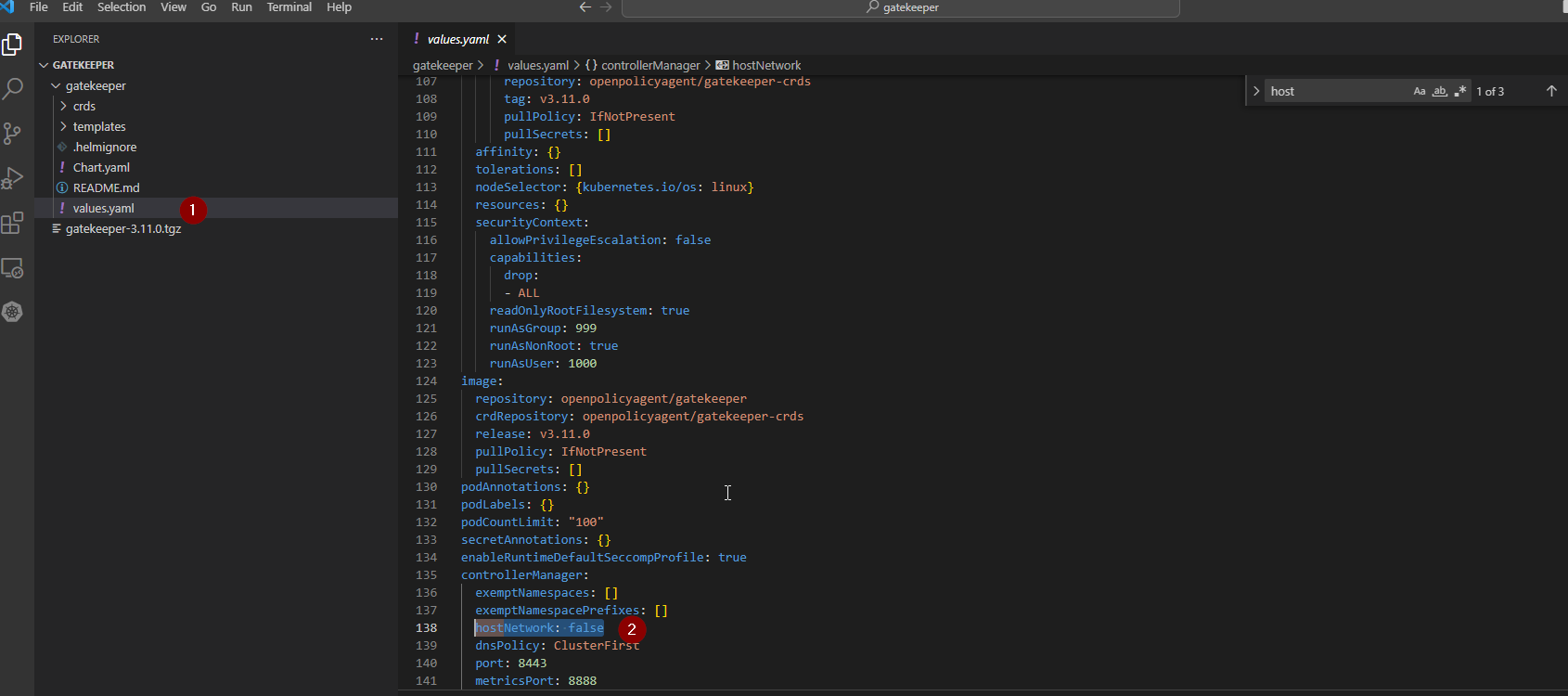

    you can change the value of the hostNetwork from helm chart Values.yaml file once you pull it from this link
    1- helm repo add gatekeeper https://open-policy-agent.github.io/gatekeeper/charts
    2- helm pull gatekeeper/gatekeeper
    3- tar -zxvf gatekeeper-3.11.0.tgz
    you can change the value of the hostNetwork to false from the values.yaml as below :
    or you can add --set flag using helm command :
    helm install -n gatekeeper-system [RELEASE_NAME] gatekeeper/gatekeeper --set controllerManager.hostNetwork=false

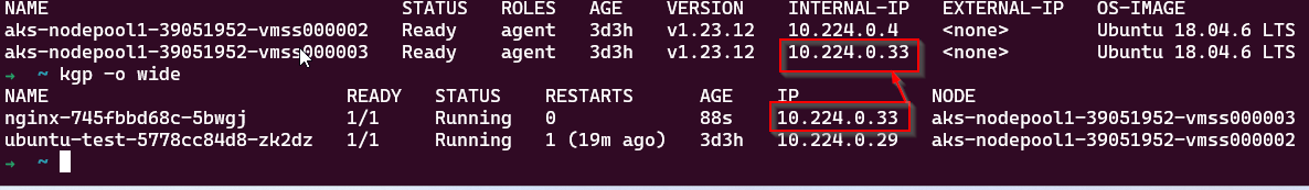

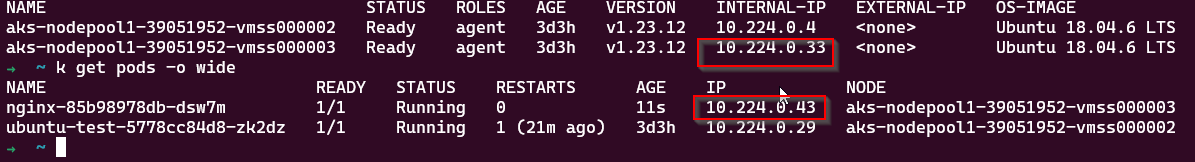

    once you start to change the host network from true to false, it will assign normal IP from the pods CIDR range.
    example:
    deployment it use hostnetwork is set to true as below:
    the POD created it took the same IP of the node:
    once you remove the Hostnetwork flag it will take IP from the same pod IP range.

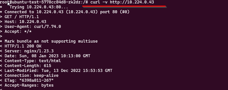

    once you exec pod and test it will work with you with the new POD IP or the service name/IP

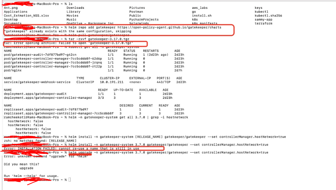

  3. Ammar-Abdlqader 1,176 Reputation points Microsoft Employee
    2023-01-09T15:24:53.163+00:00
    hello @sns
    can you try to add flag --install as below :
    helm upgrade --install -n gatekeeper-system 3.7.0 gatekeeper/gatekeeper --set controllerManager.hostNetwork=true
