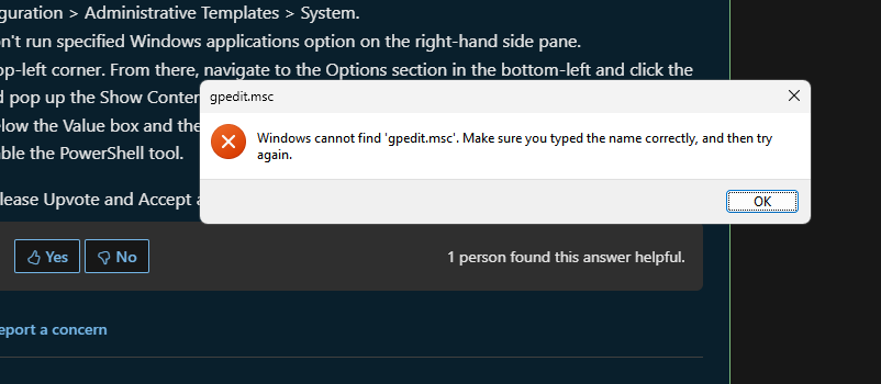

    Alternatively, you can use local policies to prevent it from executing with the next steps:
    1.Press Win + R to open the Run command dialog box.
    2.Type gpedit.msc and press Enter to open the LGPE.
    3.Navigate to User Configuration > Administrative Templates > System.
    4.Double-click on the Don't run specified Windows applications option on the right-hand side pane.
    5.Select Enabled in the top-left corner. From there, navigate to the Options section in the bottom-left and click the Show button. This should pop up the Show Contents screen.
    6.Type powershell.exe below the Value box and then press OK. Next, press Apply and then press OK in the LGPE window. This should disable the PowerShell tool.

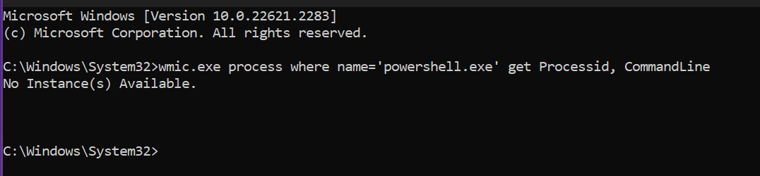

    In the details tab, right click the column headers and select "Select columns". Add "Command line". What script is it executing? Does that give you an idea of what launched it and what its doing?
    Download and run Autoruns. See if you can find any reference to Powershell or the script name. Check the Scheduled Tasks first.
    https://learn.microsoft.com/en-us/sysinternals/downloads/autoruns
