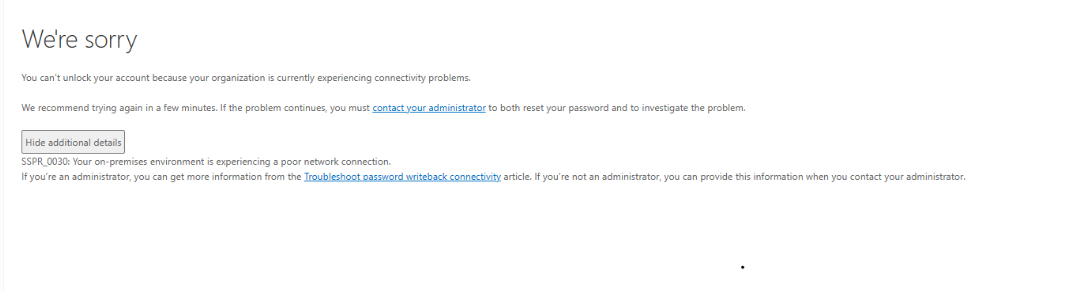

Hi There,
Our users are intermittently seeing the attached screenshot when resetting their password.
We have on-prem AD synchronising to Azure AD and can confirm password writeback is enabled.

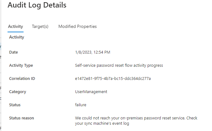

I found this site (https://learn.microsoft.com/en-us/azure/active-directory/authentication/troubleshoot-sspr-writeback) but cannot figure out where I am supposed to see these errors or where the logs are supposed to appear. Event viewer? Somewhere in Azure?
Can I get some assistance on this please?

  1. Givary-MSFT 35,626 Reputation points Microsoft Employee Moderator
    2023-01-09T05:51:49.507+00:00
    @Winston Tran Thank you for reaching out to us, add to the above steps

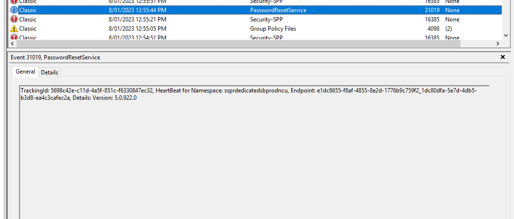

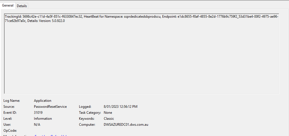

    1. Any changes have been made with respect to on-premise password policy or any changes made on the network layer.
    2. All password reset service events can be visible in the application event logs and any changes related to TLS can be seen in system logs, so reviewing Application/system logs at the time of issue can give more insights.
    3. Is the issue is intermittent? All users experience this issue?
    4. If you have Active/Staging AD Connect setup, try to change the staging ad connect server to primary and vice versa, verify if the issue persists.
    5. Version of Azure AD Connect?
    6. At the time of issue execute this command Start-NetworkConnectivityDiagnosisTools from the Azure AD Connect server (https://learn.microsoft.com/en-us/azure/active-directory/hybrid/reference-connect-adconnectivitytools)
    7. You can capture a network trace from the Azure AD Connect server at the time of issue to investigate further.
