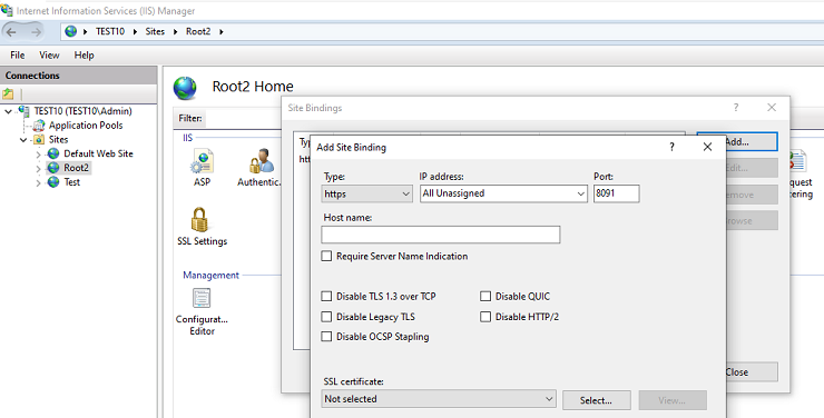

  2. MotoX80 36,401 Reputation points
    2023-01-11T14:16:10.7166667+00:00
    In the Action pane, under Edit Site, click on Bindings. Add an HTTPS site on the desired port and select a certificate to use.

  4. Bruce (SqlWork.com) 78,006 Reputation points Volunteer Moderator
    2023-01-11T17:02:27.21+00:00
    the ssl certificate is tied to the hostname, not the port. the default port for https is 443, but can be overridden. ex:
    https://localhost:5001
    you must create a ssl cert for the test server dns name and install. then for the site you want ssl, add the protocol and specify a unique port.
    your network group should define the certificate so it is trusted. but you can use a self-signed cert. but this will need to be trusted by each client.
