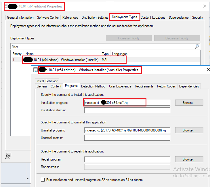

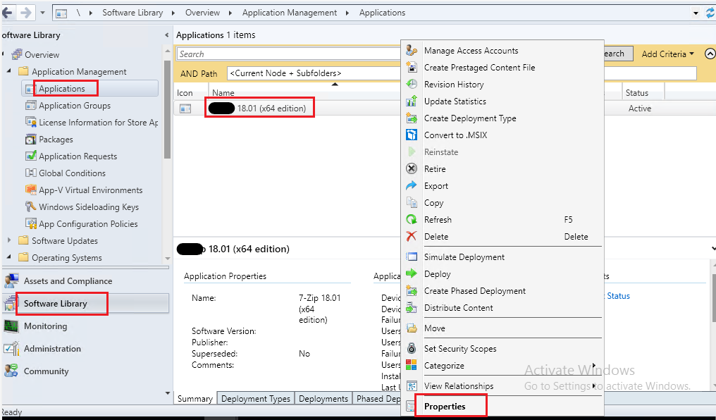

    1, The task sequence includes the step to install WalkMeWorkstation, right? If so, please upload a full smsts.log for our reference.
    2, Please try to simulate the SCCM installation process and manually install the application on the test machine to check if there is the same error.
    As show in the following screenshot, I am using command “msiexec /i “XXX.msi” /q” to install this application, I will copy the application to a test machine and use the same command to install it manually.
    1
    2
    Looking forward to your feedback.
    Best regards
    Cherry
