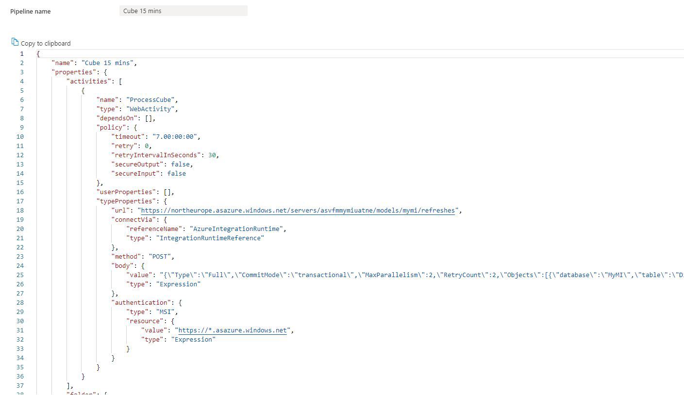

##[error]ADFT0010: Wrong path defined in config for object(path): pipeline.Cube 15 mins(properties.activities.typeProperties.url)
Do I just need to make a small change in a config file or would I need to get my head around this particular pipeline?

    Thank you for the details. As per the below error message, the specified path - properties.activities.typeProperties.url , for the object "pipeline.cube 15 mins" is incorrect. It could be that the path is not valid or that this path cannot reach using the URL.
