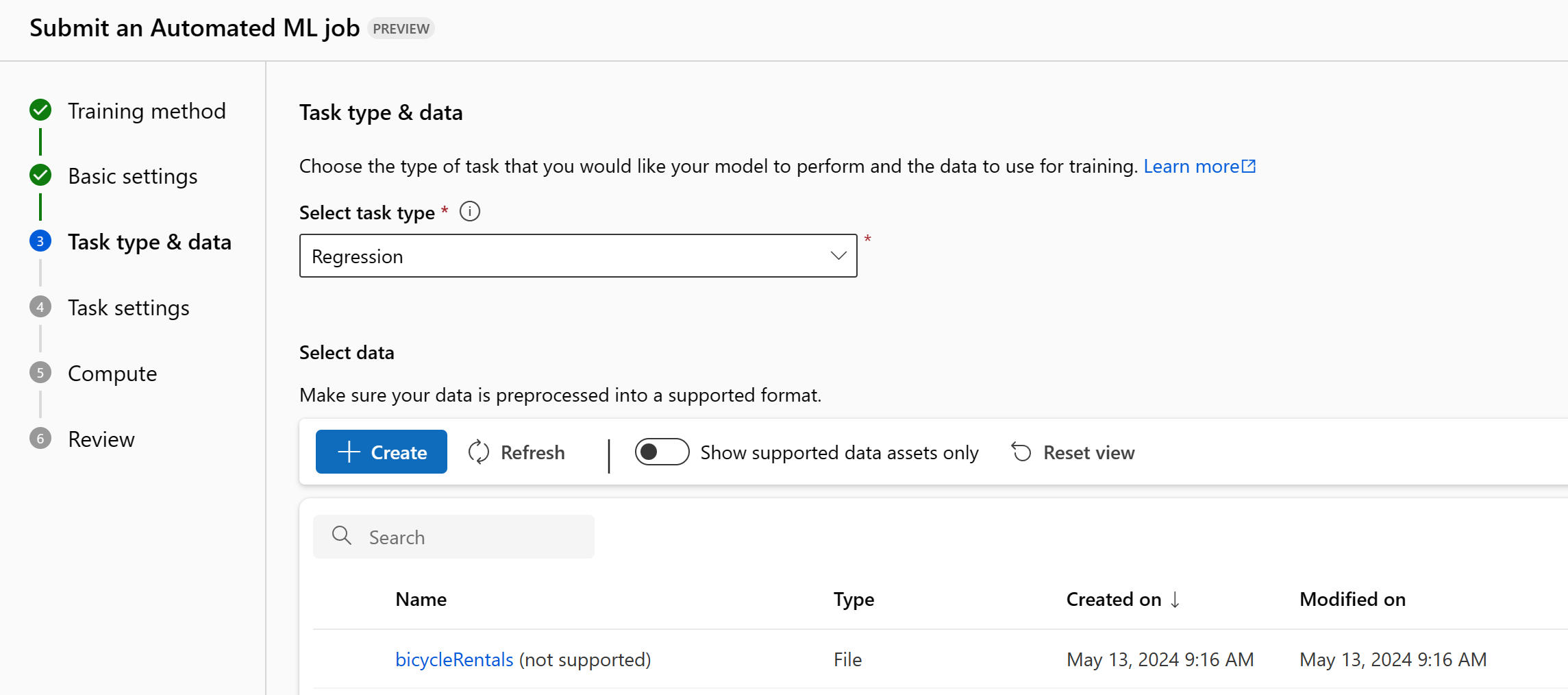

I successuffly created a data asset (folder_URI type) with uploaded imges in an Azure Blob storage (registered storage source), but when I try to create a job in Azure AutoML the Data asset shows (not supported).
select data asset
Any idea what is the issue?

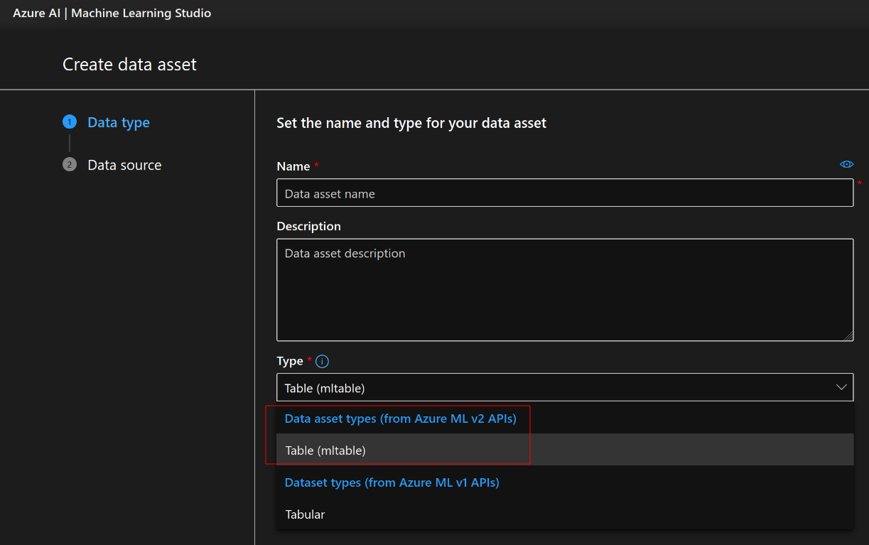

  1. Manuel Bachmann 80 Reputation points
    2024-10-28T12:44:53.2066667+00:00
    I also stumbled across this issue.
    You have to select the "Table (mltable)" under "Data asset types (from ML v2 APIs" during the data creation.User's image
