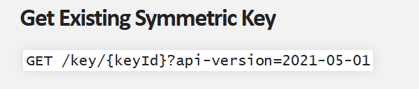

  • My understanding from reviewing the AIS API Documentation is that the Azure Identity Service provides and endpoint to retrieve the certificate, but not key information when using x509 authentication for the device identity.
  • It is possible to access the certificate and key from the file system, but I am looking for a more graceful implementation that allows my device client to leverage the APIs exposed by AIS to authenticate it's connection with IoT Hub.
