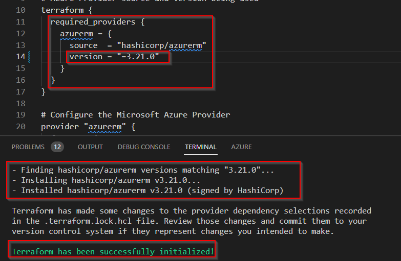

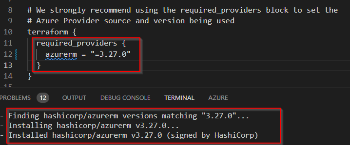

I wanted to disabled the public network access in azure keyvault, for that I am running terraform script and added the argument public_network_access_enabled argument in main.tf file. Also, I have upgraded the azurerm version = 3.21.0 as per terraform documentation. when I ran the terraform, I am getting below error.
Error - public_network_access_enabled argument is not expected.
Please find below screenshot of the configurations.

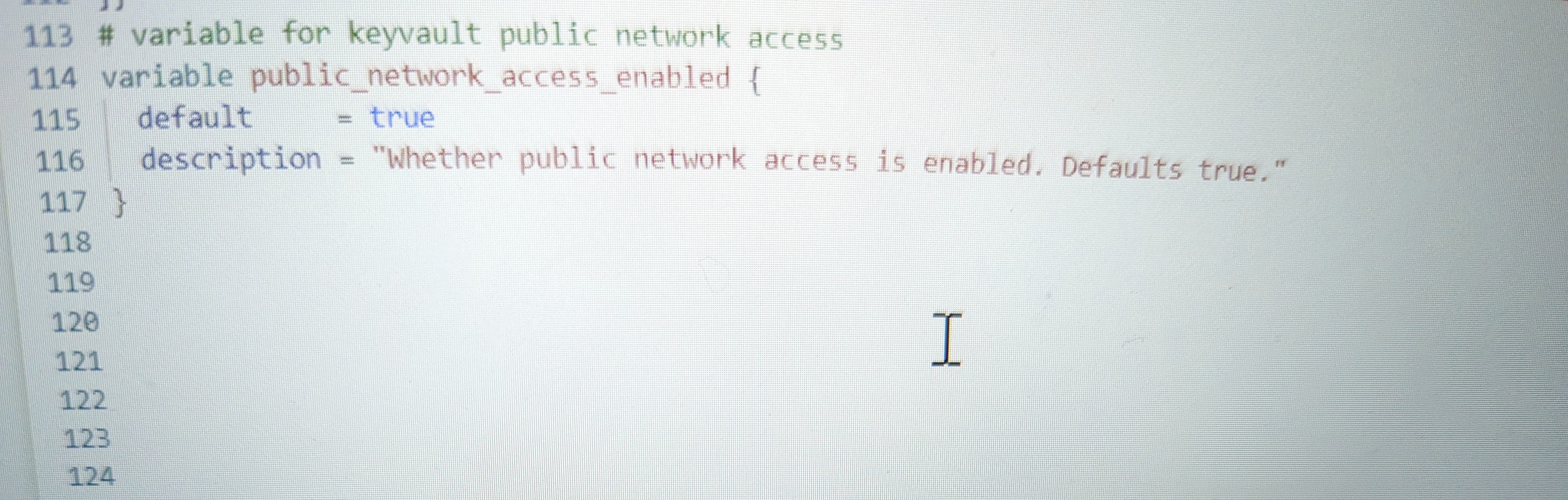

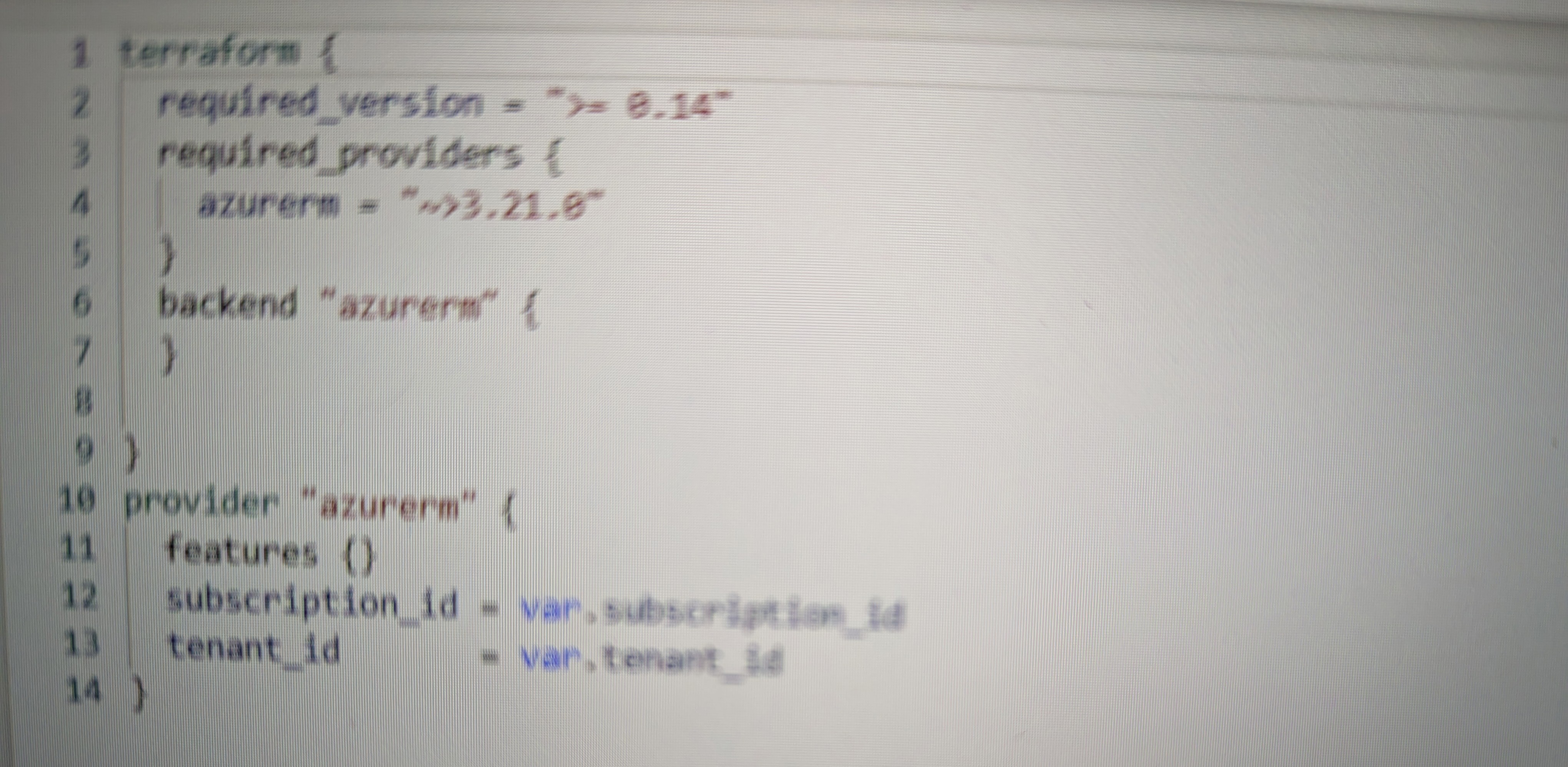

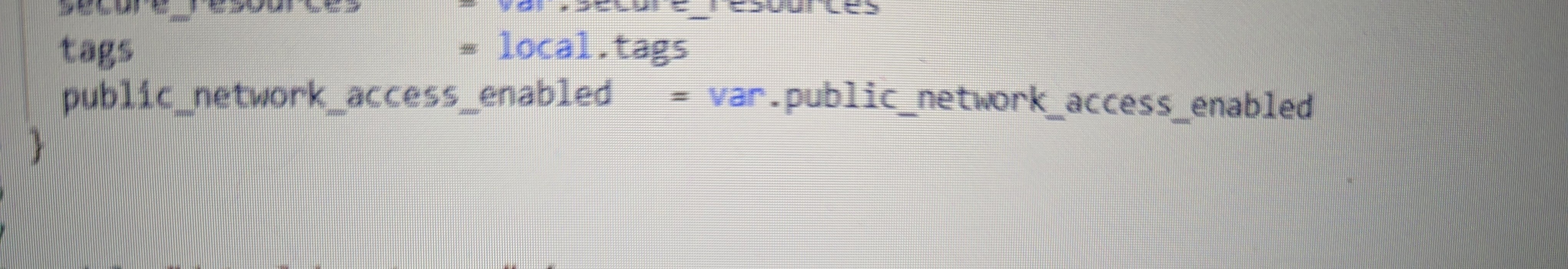

Main.tf=main.tf
variable.tf = variable.tf
version.tf =version file

  1. Santhi Swaroop Naik Bukke 595 Reputation points
    2023-01-20T20:16:06.0666667+00:00
    In the code you provided, the public_network_access_enabled variable is set to var.public_network_access_enabled. You can change the value of this variable to false to disable public network access for the Key Vault.
