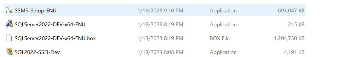

I am not able to connect to database engine
How can i solve this error?

    Unfortunately you didn't provide us enough information. How are you trying to connect to the DB? Are you using SSMS, Data Sources, etc? Screenshots and more information would be greatly helpful in speeding up getting answers.
    The error itself indicates there is no SQL instance listening. This could be for a variety of reasons:
    • There is no SQL instance on that machine.
    • The SQL instance is using a non-default SQL instance name. You have to specify the instance name if it is not the default.
    • You are attempting to connect over the network and the remote SQL instance does not have network listening enabled.
    • On the local machine you can use (localhost) or . instead.

    As Erland said, SSMS is just a visual tool to help you use SQL Server better, but it is not SQL Server itself. If you don't have it installed, you need to install a SQL Server instance. You can see the name of your instance in SQL Server Configuration Manager.
    You can download from here: https://www.microsoft.com/en-sg/sql-server/sql-server-downloads
    Please refer to this article about how to install SQL Server: https://www.c-sharpcorner.com/article/step-by-step-installation-of-microsoft-sql-server-on-windows-system/
    This article has some options of features that you can install according to your needs.

    You said tihs started to appear after you had upgraded to Windows 11. There is a known issue that may affect you.. To see if you are affected by this issue, check the SQL Server errorlog, which you find in C:\Program Files\Microsoft SQL Server\MSSQL15.SSMS\MSSQL\LOG\ERRORLOG. (The exact path may be different; I have to guess a little about your installation.)
    If you see a message about 256 misaligned reads, you are facing the known issue. See https://learn.microsoft.com/en-us/troubleshoot/sql/database-engine/database-file-operations/troubleshoot-os-4kb-disk-sector-size for workarounds.
    If you don't see this error, feel free to upload your errorlog here. (You need to rename it to ERRORLOG.txt to be able to.
