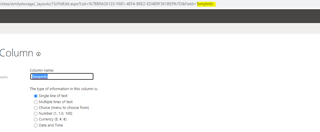

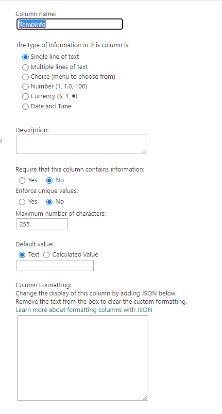

    Select distance column -> Column settings -> Format this column -> Advanced mode -> Add following codes.
      "$schema": "https://developer.microsoft.com/json-schemas/sp/v2/column-formatting.schema.json",
      "elmType": "div",
      "txtContent": "=[$TempInfo]"
    You should use [$ColumnName] to reference another column, the ColumnName need to be the internal name instead of the display name. To check the internal name of the column, you could check it in the URL.
