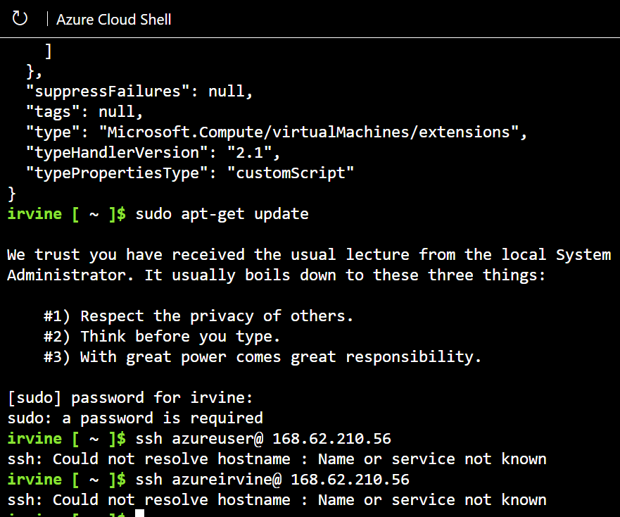

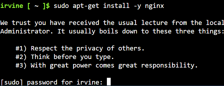

Greetings,
I was going through the azure fundamental in Microsoft learn and in unit 3 task 1 step 2 it explains to us to update our vm so as to install Nginx but doing so through Sudo apt-get update it prompts a Sudo password in which I didn't create any password on the creation of the vm, so can you help me resolve the issue or guide me on how to resolve it.
Thanks, i have attached a snapshot of the issue am facing.User's image

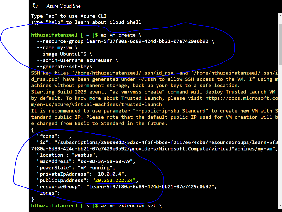

    You need to ssh to the vm you created before you can use sudo. Please see instructions below to complete the exercise.
    Please activate new sandbox and create the VM as instructed in the exercise. After Task 1 finishes, make a note of the publicIpAddress that was assigned to the VM (e.g. 20.245.72.52). Start Task 2, and then when it errors out, follow steps below:
    Connect to the newly-created VM using ssh (in cloud shell). You will need to substitute the publicIpAddress you noted above for <VM public ip address> below:
    ssh azureuser@<VM public ip address>
    Enter yes when you are prompted.
    Copy and right-click -- paste the following three commands below in the cloud shell window. Wait for each to complete before pasting in the next command.
    sudo apt-get update
    sudo apt-get install -y nginx
    echo "<html><body><h2>Welcome to Azure! My name is $(hostname).</h2></body></html>" | sudo tee -a /var/www/html/index.html
    Performing the steps above should only add a couple of minutes to the process. Continue on in the module. If you have any questions please let me know in a comment.

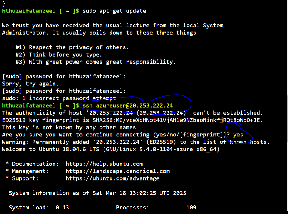

  1. Huzaifa Tanzeel 105 Reputation points Student Ambassador
    2023-03-18T13:23:53.28+00:00
    Initially running the following, note down the highlighted public ip address then proceed till sudo apt-get update and when password is not matched , type ssh azureuser@publicipaddress , substitute your public ip address noted above then press enter -> Type yes -> sudo apt-get update ->....errorfind

    still facing error can you illustrate if it's possible on how to resolve the issue. I have also attached a snapshot of the sandbox below.
    As you can see when i try to implement ssh azureuser it shows error as hostname not known. will be glad about the assist.
