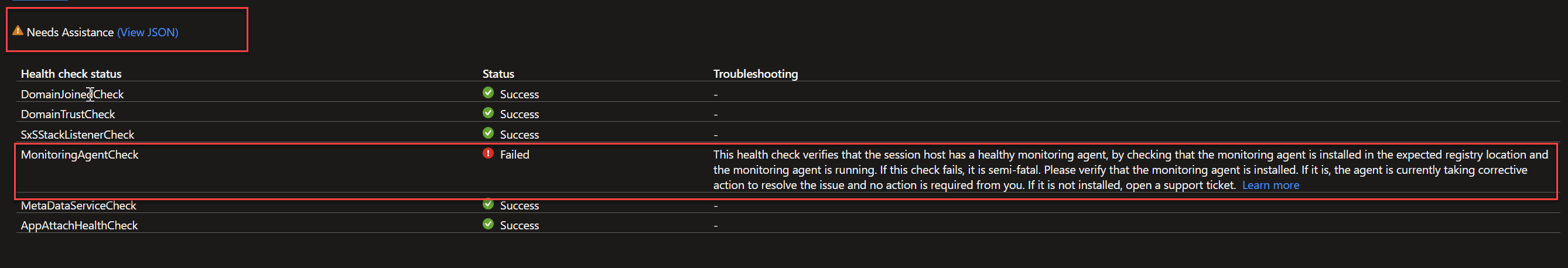

    I am using Azure Market place multi session image for my AVD (So it is not a custom image).
All my hosts session showing

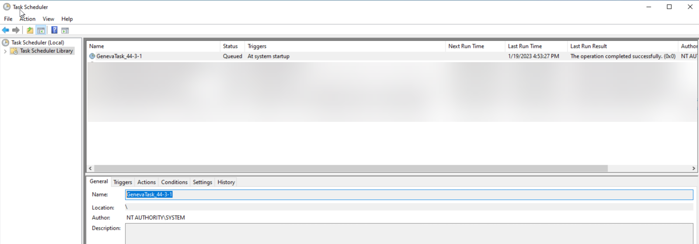

Monitoring agent is working fine, I can get data out from Log analytic fine. when look into 'GenevaTask_44-3-1' TASK Scheduler, it is showing Queued. if i click to run, session hosts showing available for while and goes back to need assistance.

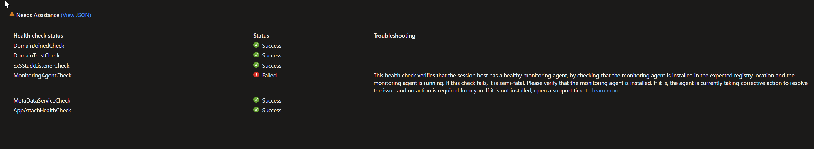

    MonitoringAgentCheck verifies that the required Geneva agent is running. If this check fails, it is non-fatal and the machine still can service connections, main issue may be that monitoring agent is missing or running (possibly) older version.
    As per your screenshot of Task Scheduler, it looks like the Geneva Monitoring scheduled task was not running, this means the GenevaMonitoringAgent did not get installed.
    Please try manually installing it by executing the Microsoft.RDInfra.Geneva.Installer-x64-44.3.1.msi as admin and restart rdagentboolader service. This should resolve the issue.

    Hello, I am working on same issue where Geneva task is in Queued state and if i click to run, session hosts showing available for a while and goes back to need assistance.
    We tried everything we can including changing registries, increasing task schedular size, running parallel instance but nothing worked.
