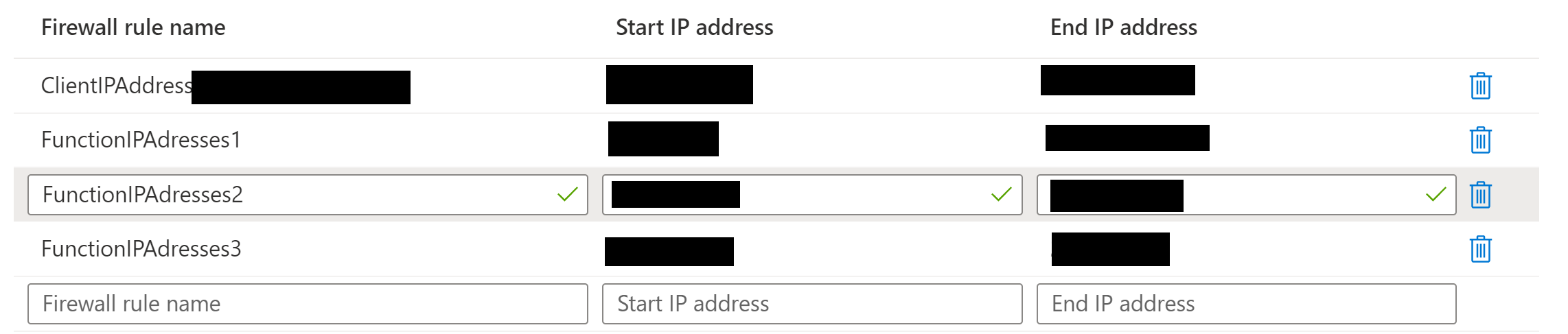

  2. Marc Jeeves 386 Reputation points
    2023-01-20T04:01:02.1766667+00:00
    so i figured it out do i need to have both these on or is one or the other enough
    either or both allows it to work but which is safer
    thank
    Marc
  3. Marc Jeeves 386 Reputation points
    2023-01-20T04:08:07.8166667+00:00
    i ended up getting all of the outbound ips from the functions and adding them to the mysql firewall rules
    is this the correct approach
