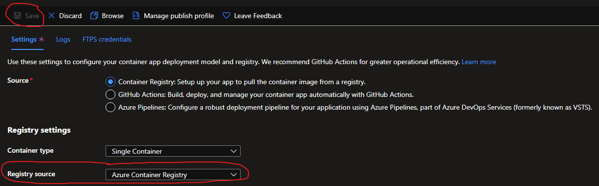

I tried to deploy an Azure Function app that is supposed to run from a custom container registry which is hosted in Azure Container Registry in the same resource group as the Azure Function app. During the Template deployment I couldn't select Azure Container Registry for the source, and it forced it to Private Registry.
Once deployed, I'm able to toggle the option to Azure Container Registry and provide all other necessary settings, however, the Save button in the Deployment Center is grayed out.

  2. JANKULOSKI Dame -C I O 5 Reputation points
    2023-01-23T13:13:58.4333333+00:00
