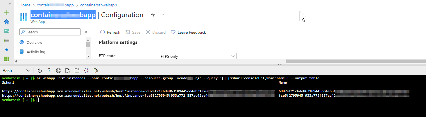

    Method 1: Azure CLI Method
    To pull the list of container instances running under your app service with their respective SSH links.
    az webapp list-instances --name <webappName> --resource-group <resourceGroupName> --query '[].{sshurl:consoleUrl,Name:name}' --output table
    Here is the sample output for reference:
    select the ssh url of the specific container from the above and browse it in your browser to connect to that specific container or you can SSH to that container using the below CLI cmdlet.
    az webapp ssh --name <app-name> --resource-group <rg-name> --instance <instance-name>
