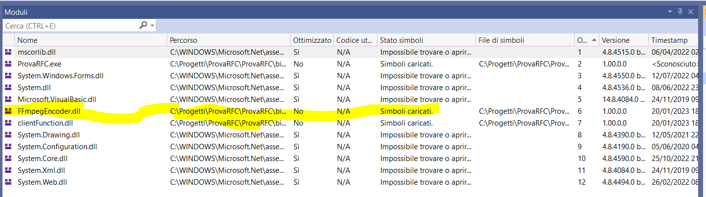

i've a solution with three projects.
One is the main project and the other two contain code that i need to debug.
One of this two projects (clientfunction) correctly load its dll into the visual studio module with all its symbols the other instead not appear in the list.
I've tried also to recreate the main project, but nothing changed.

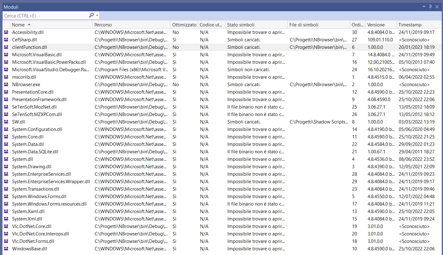

This below is a project where the dll normally appears (the one in yellow color).
and this below is another project where the same dll (yellow color above) is present in the main project but doesn't appear in the debug list of visual studio module instead it still appears (clientfunction).
Any ideas?

  2. DJG 26 Reputation points
    2023-01-21T15:08:42.54+00:00
    Dear Santhi,
    i've a main_module that starts the project.I've discovered that if i put e reference in this module to the ffmpegEncoder with a variable defined as new ffmpegencoder, when i run the project it shows me the ffmpegEncoder dll into the debug module, if i don't do this thing it doesn't insert in the debug module the dll
    Many thanks again.
