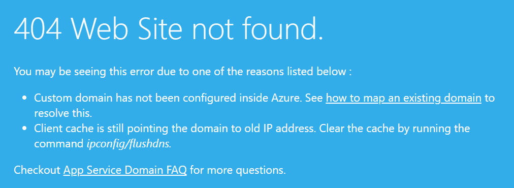

As you know if your custom domain doesn't exists on the listed custom domains of web app service your app won't respond and returns 404 (as shown in the below SS).
I wonder, if there is any way to add a custom domain from Private DNS Zone without having DNS resolver or any other service. Also, private link works if I map the VNet ip address to one of the domains listed under custom domains but not for any Private Zone ones.
One note: NsLookup result returns the public ip address (20.x.x.x) of the web app service.
Thanks

    Hi, thank you for your question at Q&A. I understand that you are running into issues connecting a custom domain to an App Service using a Private Endpoint. There is some documentation on this scenario here.
    In short: you should use the regular procedure for validating the domain via internet DNS and then make sure you have A-records in the DNS solution tied to the VNET/private network.
