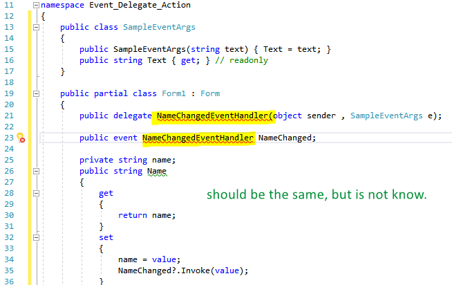

Hello,
I'm looking for a correct way to handle events and delegates. Do you have a good overview, a good example?
When is an event enough, when do I have to switch to delegates?
If I trigger an event and want to pass a complete object, then I need a delegate. Can I say it like that?
I can also trigger an event with Action. Action is also a delegate or void function.
Thanks for the support, sample.

    Event Example
    Assuming you have defined the following delegate (which is going to be used to define an event):
    public delegate void NameChangedEventHandler(string name);
    It basically is defining a type which explains a method, accepting a string parameter, and a void return value; and since I'm going to use it for an event, by assigning a name NameChangedEventHandler, I'm saying a method which is going to handle the NameChanged event, should follow that signature.
    Then you can define the event and the property and raise the event like this:
    public event NameChangedEventHandler NameChanged;
    private string name;
    public string Name
        get
            return name;
        set
            name = value;
            NameChanged?.Invoke(value);
