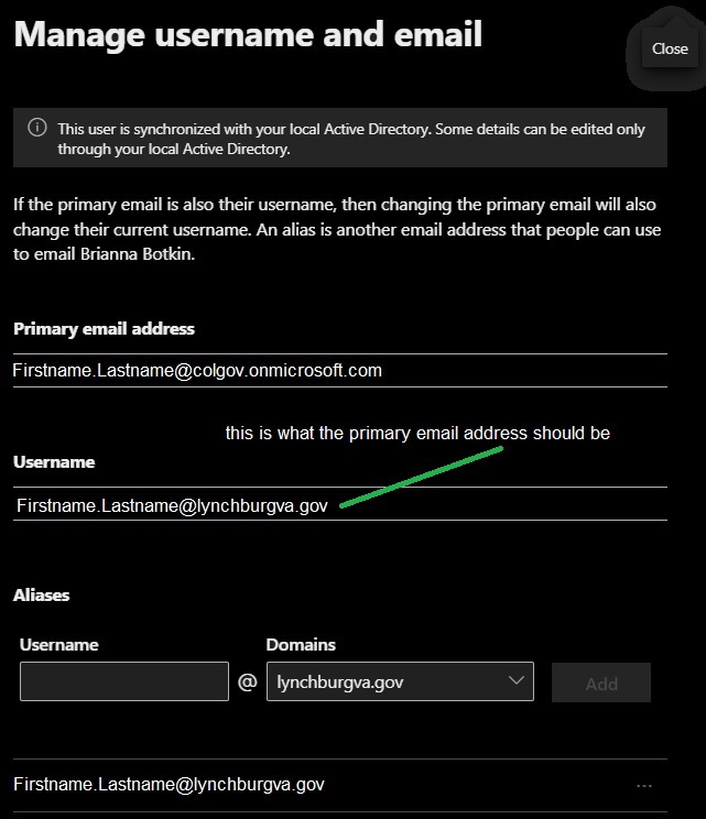

We have a local AD environment and it syncs only one way up to our Azure AD environment. I created a user account locally and used an extention attribute value "O365" which causes the record to be created in our Azure AD environment. This is the normal process and has worked fine for 1000+ user acounts. The problem I am experiencing is this new user account I created shows the ******@colgov.onmicrosoft.com address as the Primary email address in their Azure AD record. It should be ******@lynchburgva.gov, which is our local/network domain, the colgov.onmicrosoft.com should be an alias and this address has always been created automatically when the record is created and synced for the 1st time to Azure.
I cannot change this in the Azure record because it is synced to our local AD, there is a small print note at the top of the user record window displaying this:
"This user is synchronized with your local ‎Active Directory‎. Some details can be edited only through your local ‎Active Directory‎." But the local AD record shows only one email address, ******@lynchburgva.gov, which is the proper value and format.
Do you know why this is occurring for only this user and how I can reconfigure the account so the primary email address is the one with our domain name?

  1. Zafir Ahmed 45 Reputation points
    2023-05-30T14:22:07.2733333+00:00
    Go To active Directory >find the Users > go to Properties > attribute Editor > add the address to ProxyAddressess object Like SMTP:******@xyz.com and sync the active directory

  2. afar 30 Reputation points
    2023-11-14T15:35:57.01+00:00
    For some reason for me if the proxyAddress had a capitalized "SMTP", they system would interpret that as the primary email address (and if there were multiple, the first capitalized address would be primary). Really confusing and frustrating, but when I changed all of the SMTP to smtp in the proxy addresses, it went back to normal.

  4. Vasil Michev 127.9K Reputation points MVP Volunteer Moderator
    2023-01-24T19:05:32.38+00:00
    Do you see the desired address at all in Exchange Online? Is it assigned to the same user or a different one? Easiest way to check is via the Get-Recipient cmdlet:
    Get-Recipient ******@domain.com
    Depending on the result, you either have to remove the alias for any additional objects returned by the above query, or simply to set it as primary one. Strongly recommended to perform this operation on-premises. Back in the day, there was a workaround that enabled you to change the PrimarySMTPAddress directly in the cloud, but this is not a supported solution (and no longer works):
    Set-Mailbox ******@domain.onmicrosoft.com -WindowsEmailAddress ******@domain.com
  5. Alex Pettigrew 5 Reputation points
    2023-02-13T23:59:09.71+00:00
    https://learn.microsoft.com/en-us/troubleshoot/azure/active-directory/proxyaddresses-attribute-populate
    Ensure the proxyAddresses attribute is filled out with SMTP:******@domain.com.
