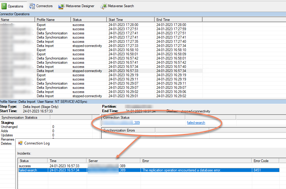

Synchronization Service Manager shows that is is the Delta Import for our-domain that fails with the error 'The replication operation encountered a database error', error code 8451. The delta import for our-domain.onmicrosoft.com ends with succes, as do all the other synchronization tasks:
Any ideas to what the cause of this might be? I'm a little stumped :(

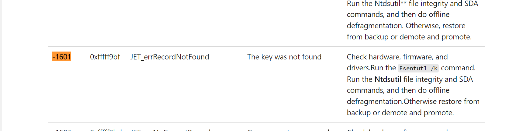

    I have however noticed that I get this error on my PDC with every synchronization attempt:
    - <Event xmlns="http://schemas.microsoft.com/win/2004/08/events/event">
    - <System>
      <Provider Name="Microsoft-Windows-ActiveDirectory_DomainService" Guid="{0e8478c5-3605-4e8c-8497-1e730c959516}" EventSourceName="NTDS Database" />
      <EventID Qualifiers="49152">1168</EventID>
      <Version>0</Version>
      <Level>2</Level>
      <Task>9</Task>
      <Opcode>0</Opcode>
      <Keywords>0x8080000000000000</Keywords>
      <TimeCreated SystemTime="2023-01-25T10:08:57.839237900Z" />
      <EventRecordID>30786</EventRecordID>
      <Correlation />
      <Execution ProcessID="636" ThreadID="3504" />
      <Channel>Directory Service</Channel>
      <Computer>pdc.mydomain.xxx</Computer>
      <Security UserID="S-1-5-21-3135561391-2215252232-3658666570-29115" />
      </System>
    - <EventData>
      <Data>-1601</Data>
      <Data>fffff9bf</Data>
      <Data>2070ab5</Data>
      <Binary>0A07000000000000A8340000A7000000</Binary>
      </EventData>
      </Event>
    So it seems there is something wrong/corrupt in my NTDS database :-(
