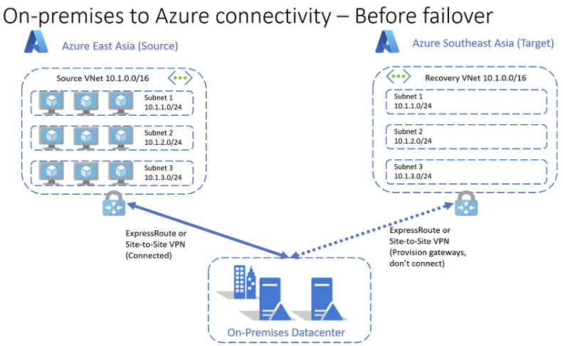

    Your scenario is illustrated here : Hybrid resources: full failover.
    • In the asr-vnet, you only provision gateways but do not establish a connection before failover.
    • User's image

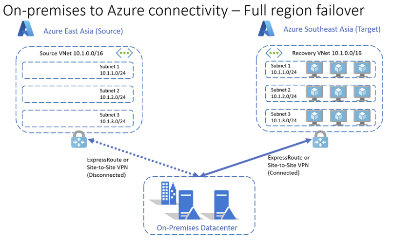

    • And After failover, you can delete/disconnect the original connection object and create a new connection with the asr-vnet.
    • User's image

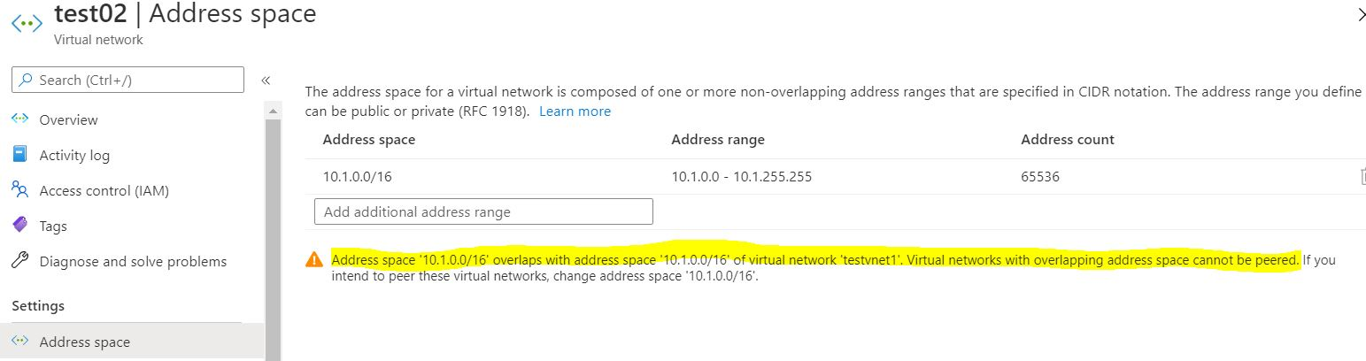

  1. Luke Murray 11,436 Reputation points MVP Volunteer Moderator
    2023-01-24T19:02:59.2733333+00:00
    It does, if the address space matches, it won't be able to be peered:
    Your best bet would be to change the address space to the range that doesn't overlap with on-premises and any other network in Azure, to avoid routing issues..
    https://learn.microsoft.com/en-us/azure/virtual-network/update-virtual-network-peering-address-space#modify-the-address-range-prefix-of-an-existing-address-range
