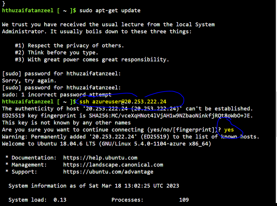

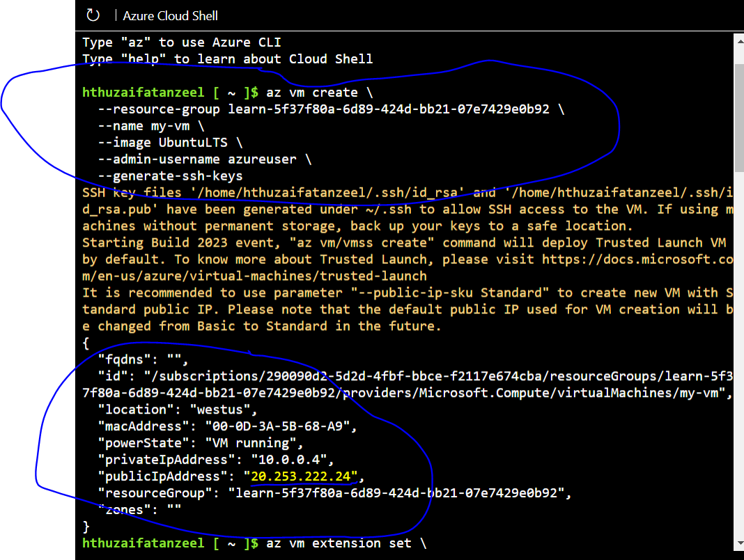

  1. Huzaifa Tanzeel 105 Reputation points Student Ambassador
    2023-03-18T13:21:28.5333333+00:00
    Initially running the following, note down the highlighted public ip address then proceed till sudo apt-get update and when password is not matched , type ssh azureuser@publicipaddress , substitute your public ip address noted above then press enter -> Type yes -> sudo apt-get update ->....
    az vm create \
      --resource-group learn-5f37f80a-6d89-424d-bb21-07e7429e0b92 \
      --name my-vm \
      --image UbuntuLTS \
      --admin-username azureuser \
      --generate-ssh-keys
    errorfind
    errorfind2
