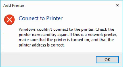

But I can't get the printer installed on the Windows Server 2016 print server.
Error on the Windows Server 2016 Machine
Meanwhile, on the server, I can still connect or install other printers of the same kind connected to other WIndows 10 machines.
To my guess is, there's something changed in the way the communication (towards printers?) runs betwoon Server 2016 and Windows 11.

  3. Marco Cools 0 Reputation points
    2023-02-08T11:32:36.3033333+00:00
    We've solved the issue by upgrading Server 2016 to 2019.
    So it was defo some incompatibility issue...
