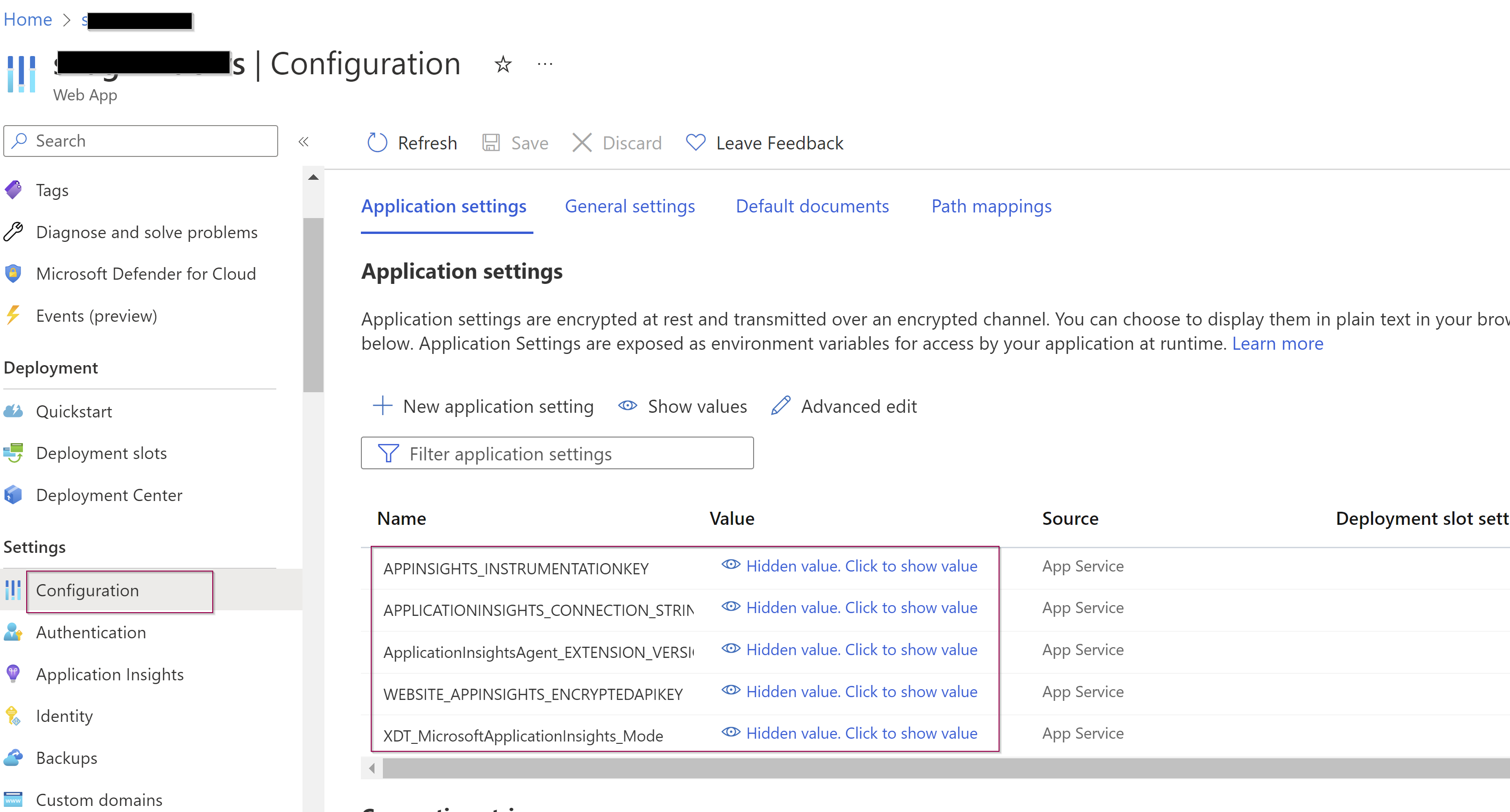

  1. SnehaAgrawal-MSFT 22,706 Reputation points Moderator
    2023-02-04T09:39:09.9233333+00:00
    Thanks for reaching here! Error: getaddrinfo ENOTFOUND, seems to path address issue.
    Check this doc link for investigating deployment issue: https://github.com/projectkudu/kudu/wiki/Investigating-issues
    Suggest you to refer this detailed article on Diagnostic Log Stream
    Also see your Application insights configuration, connection string and key is there.
    2023-01-31 11_42_33-
    Let us know.
