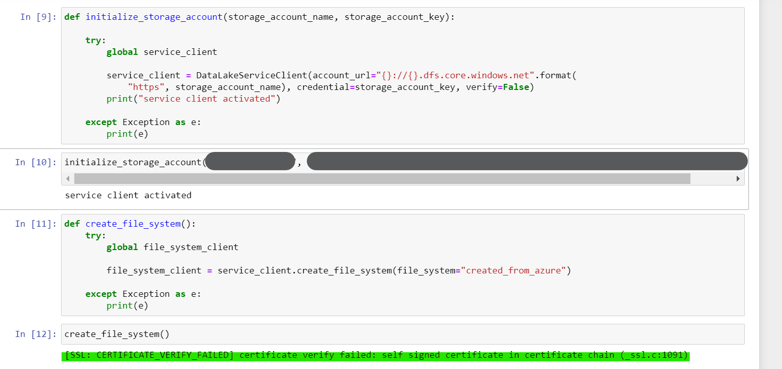

I am getting SSL error when I am trying to use Python API for file handling on ADLS gen 2
Srivastava, Anshuman 0 Reputation points
2023-01-27T11:18:05.1733333+00:00
SSL error while trying to create directory

    Did you imported the Certificates in te Storage ? As this step is required if you are using self signed certs - check the troubleshooting steps here - [https://learn.microsoft.com/en-us/azure/storage/common/storage-explorer-troubleshooting?tabs=Windows

    Hello @Srivastava, Anshuman,
    You can use the below command to pass certificate in python script.
    import requests
    cert_file_path = "cert.pem"
    key_file_path = "key.pem"
    url = "https://example.com/resource"
    params = {"param_1": "value_1", "param_2": "value_2"}
    cert = (cert_file_path, key_file_path)
    r = requests.get(url, params=params, cert=cert)
    This is discussed here.
