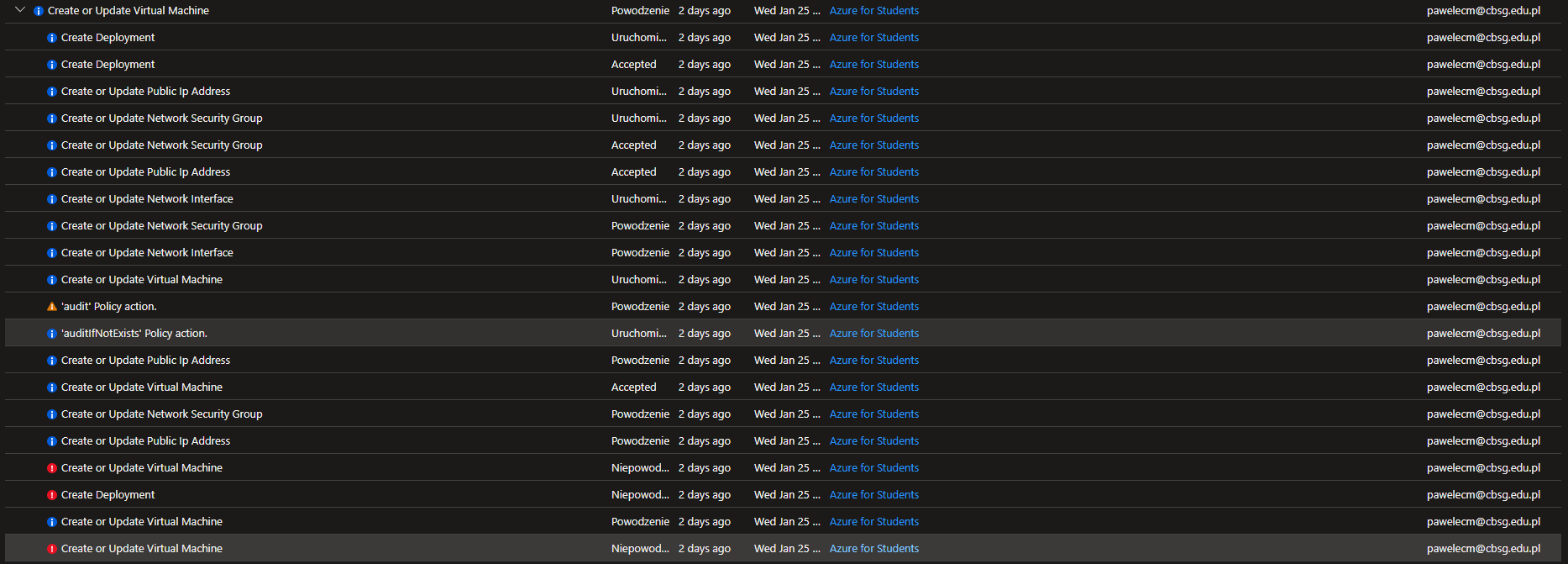

About 3 days ago i wanted to test something with virtual machines. So i went up and started configuring a VM trough azure portal. After couple of minutes virtual machine, public IP, NSG, VNET and network interface was created. I tried to connect to the VM but the following error has appeared

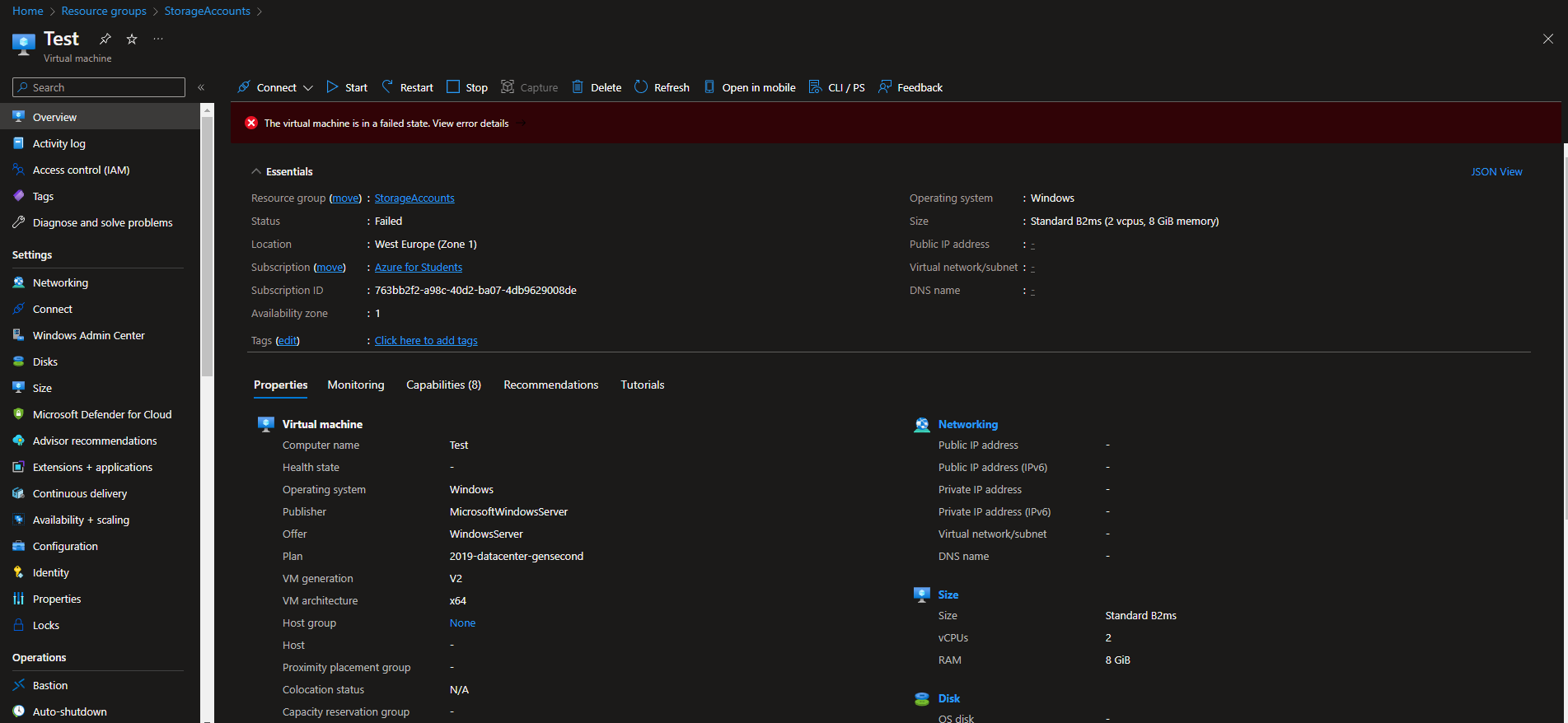

So i went back to the resource group in wich the virtual machine was created but i realised that there is no virtual disk
error1
However when i went back to a virtual machine and opened disk tab. I could see that there was a disk
error3
However when i tried to locate that disk using powershell cmdlets it turned out that such disk doesn't exist. Oddly enough network interface got assigned to the virtual machine.

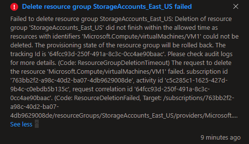

So i thought, ok something must went wrong . I will force delete the virtual machine trough azure portal and the following error appeared
MicrosoftTeams-image

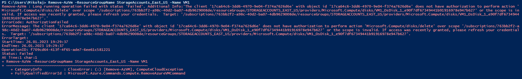

I tought well ok i will try to do the same using Remove-AZVm and it also returned the error
error5

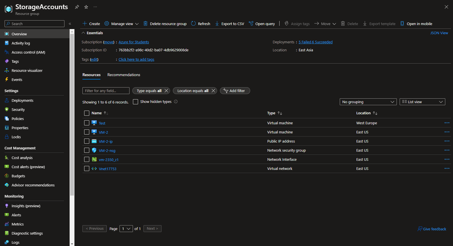

Then I tried to force delete resource group trough portal. Not only that it took more than an hour to finish but it also didn't work.
Usuwanie_RG
So i went up and tried to delete the resource group using Remove-AzResourceGroup. No luck it also didn't work and took ages to trow an error
error4

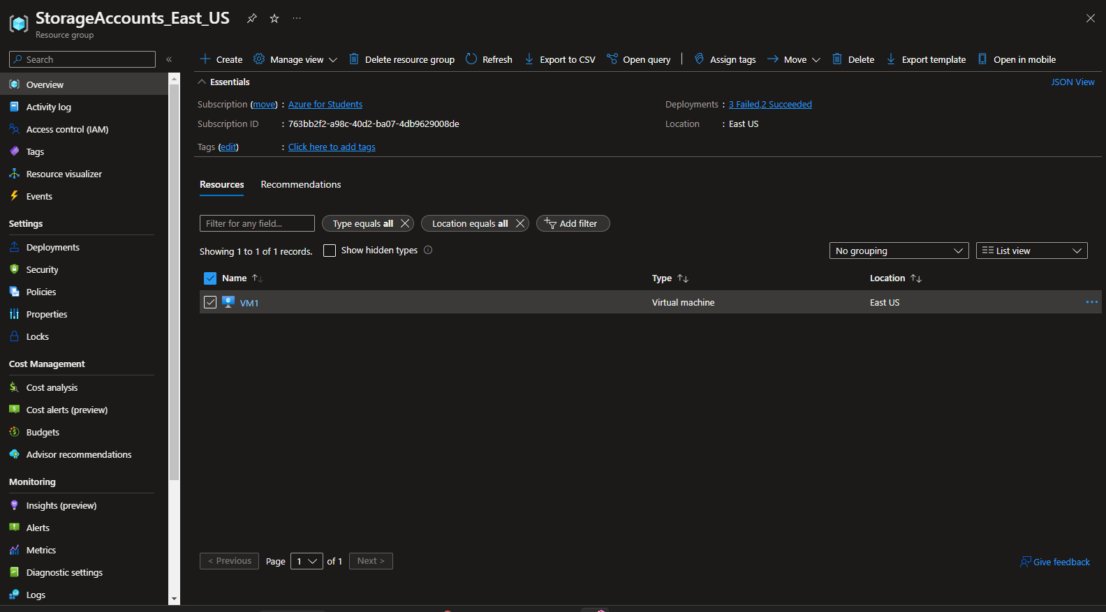

I also created new resource group and a new virtual machine because i thought that maybe the problem was in the resource group and same thing happened. I was getting same errors when trying to delete resources and resource group exept this time only the virtual machine remained (see below).
MicrosoftTeams-image2

    Microsoft Support did advise that I delete the subscription as everything I tried was fruitless. This was on an account that was originally set up using free credits during first month, but then was converted to Pay as you Go. They are graciously forgiving the charges due to the firewall that was left sitting on, and then further charges for public IP address that refused to budge. It was an important learning lesson to not race to stage or "stand up" deployments. And when it's time to "tear down resources" there can be consequences. Thanks for reading.
