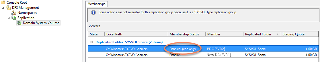

    When I open the DFS management console I see this:
    This supports what the 4004 event tells me: Error: 9075 (The content set is read-only and can't be a primary).
    Any ideas how to solve this?
