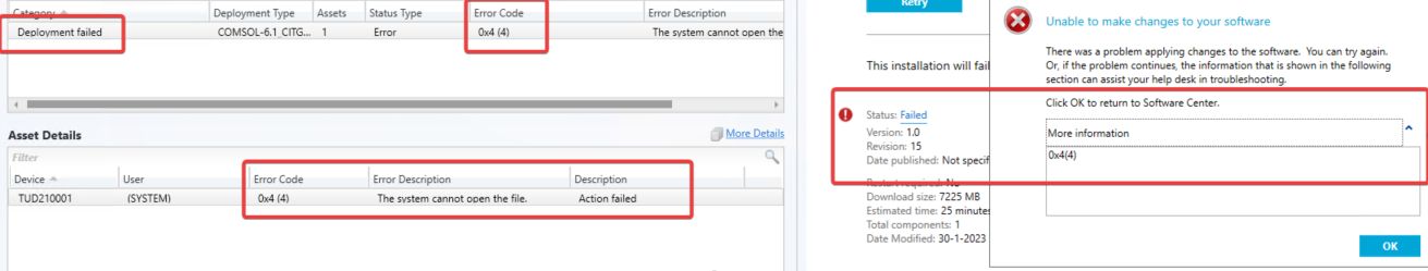

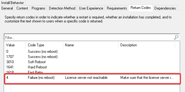

So I added this return code 4 to the "Return Codes" tab of the deployment type:
But the Appenforce.log keeps telling me the exit code 4 is unmatched.

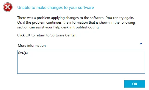

Also there is no feedback for the user from Software Center:
What am I missing here?

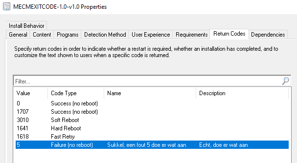

    I have isolated the problem, in this case I used en exitcode of 5.
    Just a install.cmd with:
    exit /b 5
    Same issue:

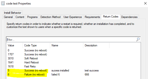

    I test it in my lab, if I add a custom return code 6 Failure(no reboot), I get the same result as you, but if I add a custom return code 5 Success(no reboot), it matched the exit code 5. It's really strange, I will do more research about it, if there any progress, I will update it here.
