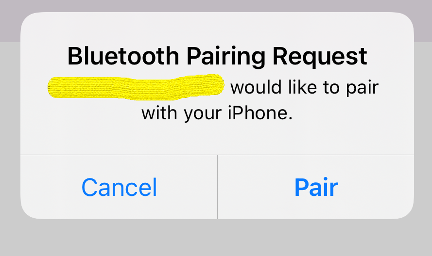

we also observe the iPhone device is receiving this log from Windows:
default 15:38:27.555377+0530 SpringBoard Received request to activate alertItem: <SBUserNotificationAlert: 0x105916a90; title: Bluetooth Pairing Request; source: bluetoothd; pid: 88>
We observed that looks like the issue reproduces more consistently when the windows restarts or reboots.
On the pairing request alert dialogue on iPhone, If I press "cancel", the app disconnects from the peripheral (Windows). If I press "pair", the peripheral nothing happens. However, Windows continues sending me pairing requests whenever the machine is restarted or rebooted.

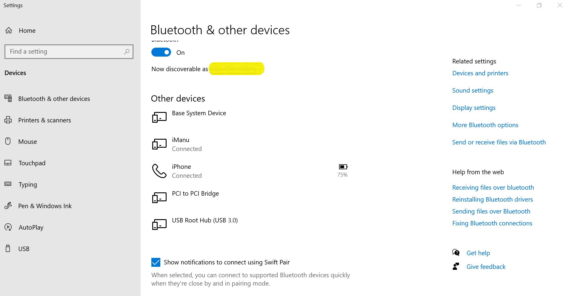

In the below screenshots, we could see that the iPhone is already paired in Windows Bluetooth Settings but the Paring is requested from Windows on iPhone to pair again and in the background, our app is successfully connected to Windows using Bluetooth Low Energy (GATT).
Pairing_Alert_on_Iphone_From_Windows
iPhone_Already_Paired
