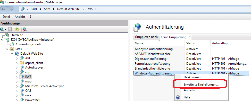

Okay... HCW Moden Full Hybrid won't work when extended Protection on MS Exchange ist active.
So i tried to configure HCW with Classic Full Hybrid... Well, i am getting the same 401 error like above.

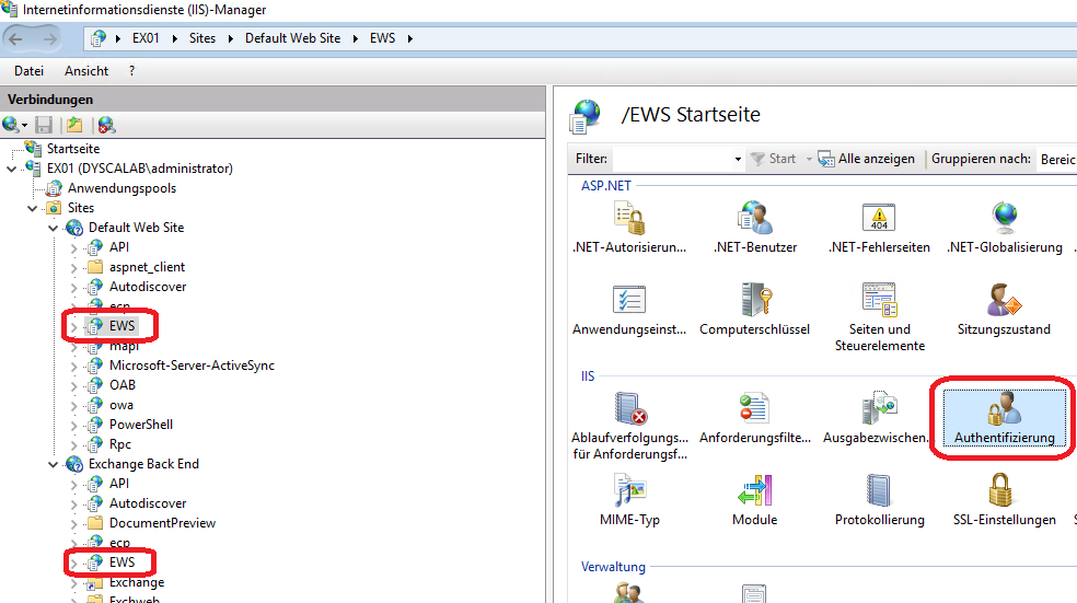

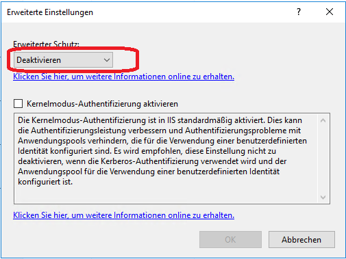

Disabling EP in IIS for EWS Front- and Back-End, all will doing fine...
Is there any other solution without reducing the security on MS Exchange?!

    You are conditionally right. My first attempt was actually the Modern Full Hybrid. After I found out after numerous hours and log sightings that it is related to the Extended Protection (EP), I switched to the Classic Full Hybrid.
    However, there were also with this the same problems:
    • 401 Error with active EP
    • Calling my local instance via the proxy URL
    Yesterday I started 2 new attempts with new tenants each:
    1st try: Implementation Classic Full Hybrid
    This initially returned a new error screen: 403
    But then: Calling my public domain instead of the proxy URL and it's working like a charm.
    2nd try: Implementing Modern Full Hybrid (because I already started this at the client, but it's not running due to the EP) and reverting to Classic Mode (to make sure the local agent is uninstalled and everything works so I can implement it cleanly at the client).
    After initial known errors and some time between configuration steps, I was able to see in the log that my public domain was being called instead of the proxy URL.
    Quintessence:
    Time is an important factor. Not only with Exchange on prem, but especially with Exchange Online.
    The HCW now ran cleanly and without errors. So now I can test the further migration steps.
