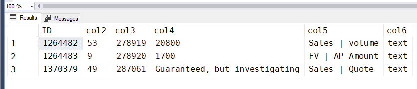

    Input file ('e:\Temp\JamesProsser.csv')
    1264482,53,278919,'20800','Sales | volume','text'
    1264483,9,278920,'1700','FV | AP Amount','text'
    1370379,49,287061,'Guaranteed, but investigating','Sales | Quote','text'
    USE tempdb;
    GO
    DROP TABLE IF EXISTS dbo.tbl;
    GO
    CREATE TABLE dbo.tbl (ID INT, col2 INT, col3 INT, col4 VARCHAR(50),col5 VARCHAR(50),col6 VARCHAR(50));
    BULK INSERT dbo.tbl
    FROM 'e:\Temp\JamesProsser.csv'
    WITH (
       FORMAT='CSV' -- starting from SQL Server 2017 onwards
       , FIRSTROW = 1
       , FIELDQUOTE = ''''
       , FIELDTERMINATOR = ','
       , ROWTERMINATOR = '\n');
    -- test
    SELECT * FROM dbo.tbl;
    Output
