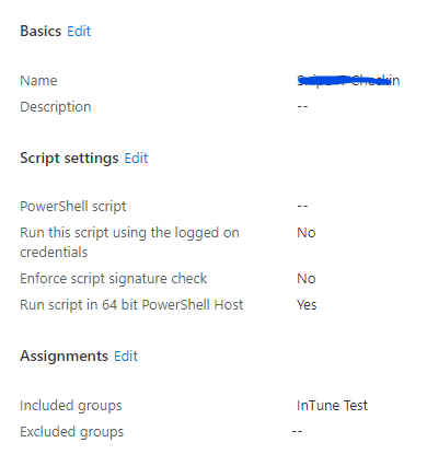

    3, How did we configure the PowerShell script in Intune? Please get a screen shot.
