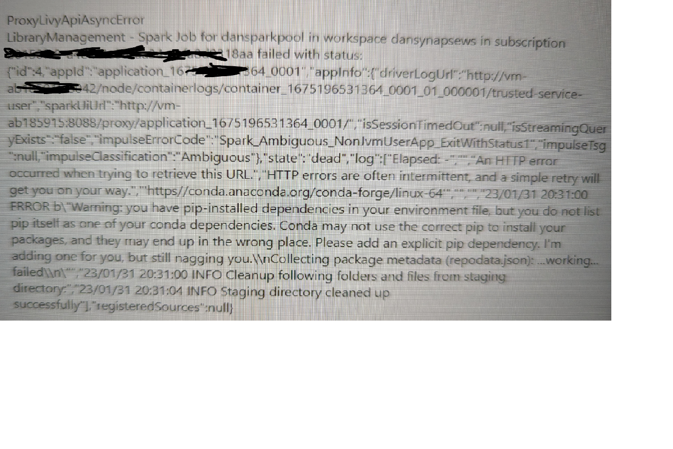

Hi All,
I am tying to install pycryptodome to azure synapse notebook. PFB details.
scenario - I have created a notebook and Apache spark pool in azure synapse. I used the Below command to list the packages installed on pool. I don't see my required packages in the list. So I tried to install it using requirement.txt file and requirement.yml file in package section of Apache spark pool.
steps performed-
pip list : command to see the packages already installed.
created below file and uploaded in package section of Apache Spark pool.
requirement.txt:
pycryptodome==3.16.0
requirement.yml code:
channels:
  • defaults
dependencies:
  • pip:
    • pycryptodome
error= PFA screenshot
please share your suggestion. Thanks!

  1. PRADEEPCHEEKATLA 91,656 Reputation points Moderator
    2023-02-03T08:35:41.8+00:00
    Hello @sachin gupta
    Thanks for the question and using MS Q&A platform.

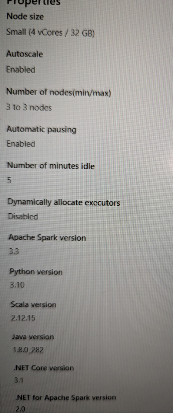

    As per the repro from my end - I'm able to successfully install the pycryptodome==3.16.0 using the requirement.txt file method.
    Note: I had tested on Spark Runtime 3.1 version. In case, if you spark runtime is different please do let me know I can re-verfiy with the spark runtime version which you are using.
    To verify if the correct versions of the correct libraries are installed from PyPI, run the following code:
    import pkg_resources
    for d in pkg_resources.working_set:
         print(d)
    Successfully installed & verfied the package installtion named: pycryptodome==3.16.0
    For more details, refer to Manage session-scoped packages.
    Hope this helps. Do let us know if you any further queries.
