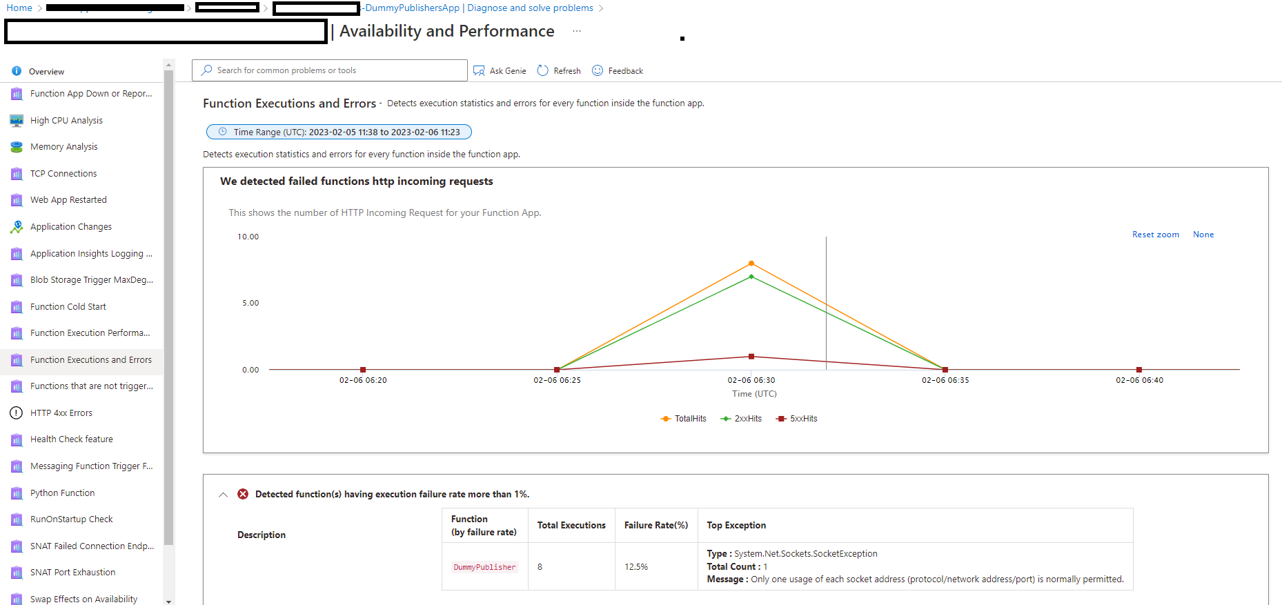

Hello, im receiving error:
2023-02-01T09:05:53.248 [Error] Executed 'myFunctionName' (Failed, Id=df08ed2f-fa3d-4d75-a50c-6d108707bce2, Duration=1042ms)Only one usage of each socket address (protocol/network address/port) is normally permitted.
Following answers from search engine this means port exhaustion, but there are following problems in my case:
  • it was working fine up to today morning;
  • traffic is very low, in example i run this function once, then second time, then third and i get error;
  • i do not open ANY http connections inside.
Whole function body below (removed namespaces from snippet as these are business classes which names i do not want to share):

  1. MayankBargali-MSFT 70,991 Reputation points Moderator
    2023-02-09T08:55:24.19+00:00
    @Szymon Thanks for the details. As you are not using cosmos DB input/output binding and using Cosmos DB client library then you need to leverage the lazy pattern as documented here. Please refer to manage connection document and for cosmos DB client
