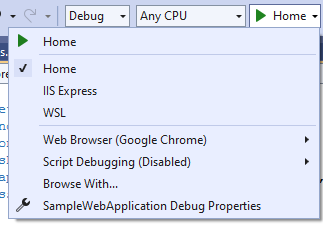

    4. Now to choose the profile or environment, open launchSettings.json which is under Properties folder and set the environment in ASPNETCORE_ENVIRONMENT:
           "iisSettings": {
             "windowsAuthentication": false,
             "anonymousAuthentication": true,
             "iisExpress": {
               "applicationUrl": "http://localhost:5061",
               "sslPort": 0
           "profiles": {
             "Home": {
               "commandName": "Project",
               "dotnetRunMessages": true,
               "launchBrowser": true,
               "applicationUrl": "http://localhost:5110",
               "environmentVariables": {
                 "ASPNETCORE_ENVIRONMENT": "Home"
             "IIS Express": {
               "commandName": "IISExpress",
                 "ASPNETCORE_ENVIRONMENT": "Development"
    This basically enables the Home environment:
    Now when you run the application, it will read the app settings from the environment that you specified in launchsettings.json.
    You can define or add any other environment that you want, using the lunchsettings.json or using the project properties as mentioned in the other answer.

    And if you run the app, with Home profile:

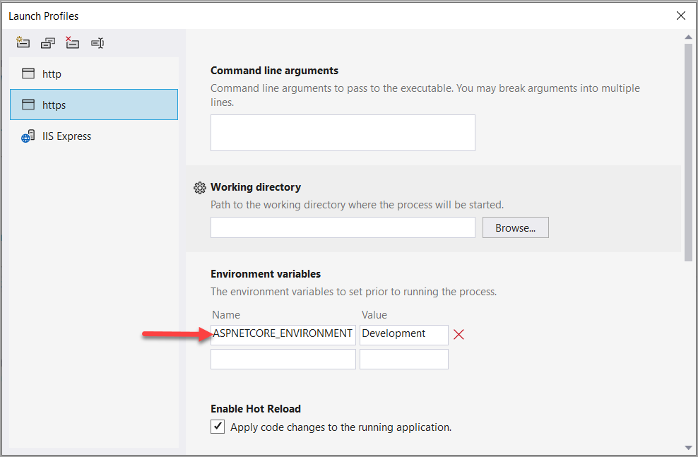

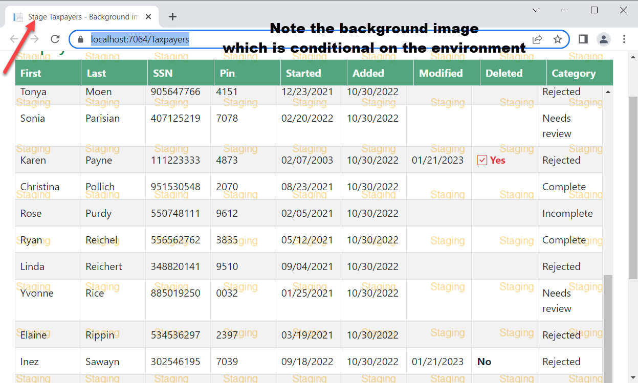

  1. Karen Payne MVP 35,591 Reputation points Volunteer Moderator
    2023-02-03T11:40:48.6433333+00:00
    Create an appsetting file for each environment e.g. appsettings.Development.Json
    2222
    Then in Startup
    public Startup(IHostingEnvironment env)
        var builder = new ConfigurationBuilder()
            .SetBasePath(env.ContentRootPath)
            .AddJsonFile("appsettings.json", optional: false, reloadOnChange: true)
            .AddJsonFile($"appsettings.{env.EnvironmentName}.json", optional: true)
            .AddEnvironmentVariables();
    Configuration = builder.Build();
    Next, in debug properties, set the environment.
    11111
    For going live, create an environment variable on the server if one server or if you have dedicated servers set them accordingly.
