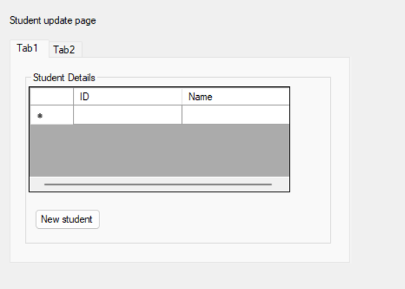

I would like to create something similar to this in ASP.NET:
Which is the best way to do it?

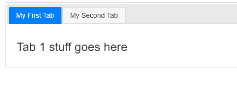

    So, the above results in this:
    tabsimple

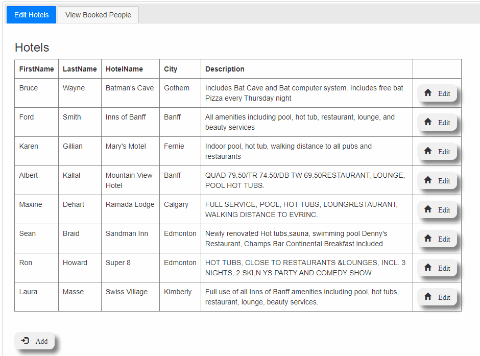

    Next up, we need some kind of table display. In most cases, a gridview works quite well.
    so, in above tabs-1 area, we can drop in a GridView. You can even use the wizard to create this grid if you wish.
    I often let the wizard create the gridview for me, then I "tweak" after a bit.
    So, lets have 2 tabs. One to display (and edit) hotels, and then say a 2nd tab to edit say booked people.
    So, our grid view will look like this (as noted, I let the wizards make most of this).

    So, change the tab names, move things around a bit, and we now see, get this:
    gridtab
    The other suggested "tab" control was the one from the ajaxtoolkit. I will admit the ajaxtoolkit is a "little less" effort to learn, since you don't have to put in any JavaScript, but either choice is fine.
    So, for your table like view, a GridView is a good choice. ListView also works rather well. And the above shows a jQuery.UI tab control in action.

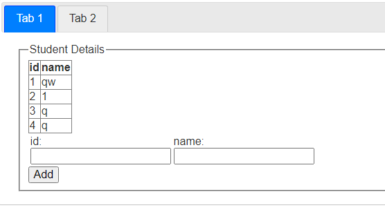

    Hi @Bill Johnson ,
    If you want to achieve a similar screen, you can use jQuery.UI tab, then add data through the gridview, and prevent the gridview from being in the panel.
    https://learn.microsoft.com/en-us/dotnet/api/system.web.ui.webcontrols.gridview?view=netframework-4.8.1
