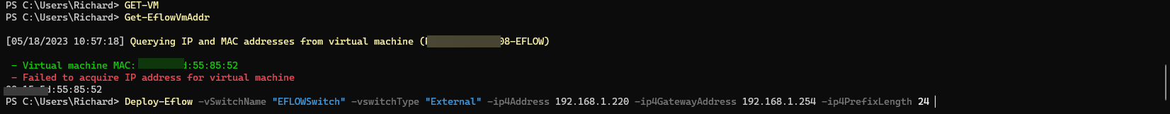

I have enabled Hyper-V and I have two internal switch.
1- Default Switch
2- nat
When Running Deploy-Eflow on my VM I am getting below Error.
Failed to acquire IP address for virtual machine
Can You please let me know why this error is coming as Deploy-Eflow should use Default Switch and switch is already present.
