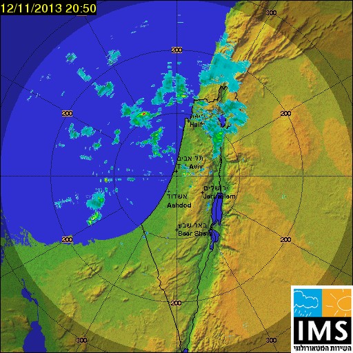

now when i'm using Paint to do this the result image is what i wanted to be :
1
The image is jpg because i can't upload here bmp images types. but the result is what i wanted to be when making the changes in Paint.

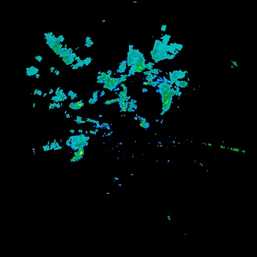

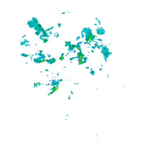

but when i'm doing it with the code the result image is :
newImage1111111
what i want to do is to get batch of images all of them are png type 940x940 size bit depth 8 and convert them to png type images size 512x512 and bit depth 32.
the method above does change the png images size and bit depth but the result is not the same as in the Paint.
in the paint when i change the size to 512x512 then save it as png it's giving me message that it will lose transparency.
but the result is fine when doing it through the code i'm getting this black image.

the image above the first one with the white background is looking the same before changing it i want to keep it with the original white background just to change the size to 512x512 and the bit depth to 32.

  1. Reza Aghaei 4,986 Reputation points MVP Volunteer Moderator
    2023-02-03T17:46:44.42+00:00
    The code is doing what it's expected to do, which is keeping the transparency, but if you need to have white background, just use g.Clear(Color.White) before you draw the image.
    For example:
    using (var input = Image.FromFile(@"C:\files\input.png"))//640x480, 8bpp
    using (var output = new Bitmap(512, 512,
        System.Drawing.Imaging.PixelFormat.Format32bppArgb))
    using (var g = Graphics.FromImage(output))
        g.Clear(Color.White);
        g.DrawImage(input, 0, 0, output.Width, output.Height);
        output.Save(@"C:\files\output.png", ImageFormat.Png);
    The output image is 32bpp, without transparency, with a white back color.
