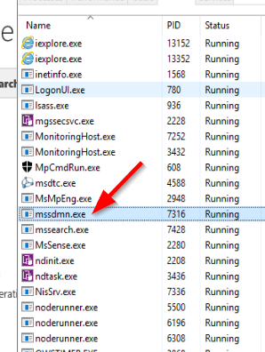

One more thing I notice that mssdmn.exe process is missing from Task Manager, I checked other environments and regardless crawl is running or not this process exist.

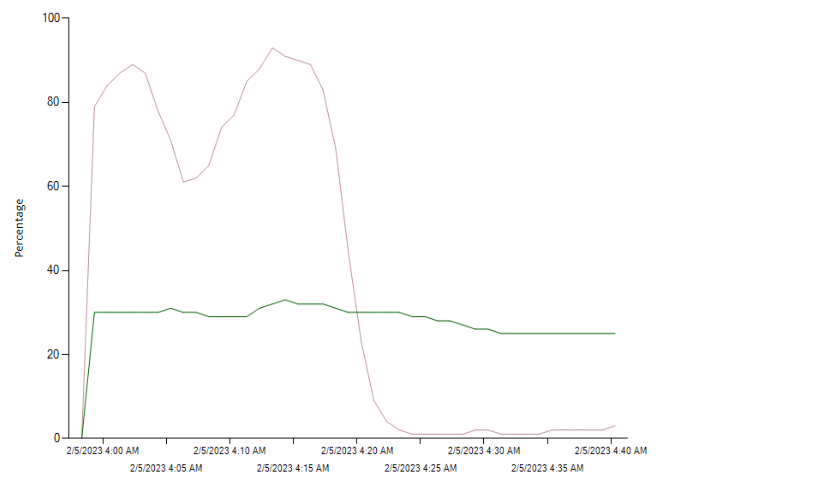

CPU usage goes up to 90% but Memory is not used more then 50%.
