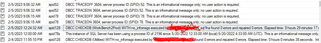

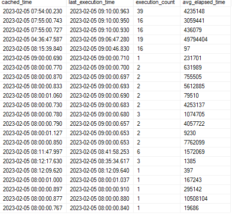

HI Experts. i was trying to find Stored procedures that ran/executed yesterday or maybe executed within last 24HRS-48HRS, and i used the below query to get info...but the strange thing I found is its always gets me only 1 hr old of data.
For example -if i run at 09:14 am est, i was able to get a history of stored procedures that ran from 8 am est only ...i was not able to get any history of stored procedures execution prior to (older than) 8 am.
  • i dont have any Job to clear the cache or i did not restart my production sql server for 6 months
  • did not find any in the SQL SERVER logs
  • This server(SQL SERVER 2014 sp3) is not having issues ,its not busy server or we don't have disk or memory or cpu issues
  • something happening in another server 2016 SP3
Kindly please provide some suggestions -Thanks
SELECT
    SCHEMA_NAME(sysobject.schema_id) SchemaName,
    OBJECT_NAME(stats.object_id) SPName,
    cached_time, last_execution_time,
    execution_count,
    total_elapsed_time/execution_count
            AS avg_elapsed_time
FROM
    sys.dm_exec_procedure_stats stats
    INNER JOIN sys.objects sysobject
        ON sysobject.object_id = stats.object_id
WHERE
    sysobject.type = 'P'
ORDER BY
    stats.last_execution_time DESC
	GO

  3. NickK 176 Reputation points
    2023-02-06T01:01:24.41+00:00
    Hi Erland Thanks for your reply.
    a little background about our environment
    • We have index rebuild and update stats jobs that run every day for 8 + years and we did not see any issues.
    • There is no memory pressure based on dmv and also didn't find any logs.
    • we have always on, replication
    • no one runs sp_configure as I am only the Admin on these servers and not many users have to write permissions.
    any idea how the cache is missing?
