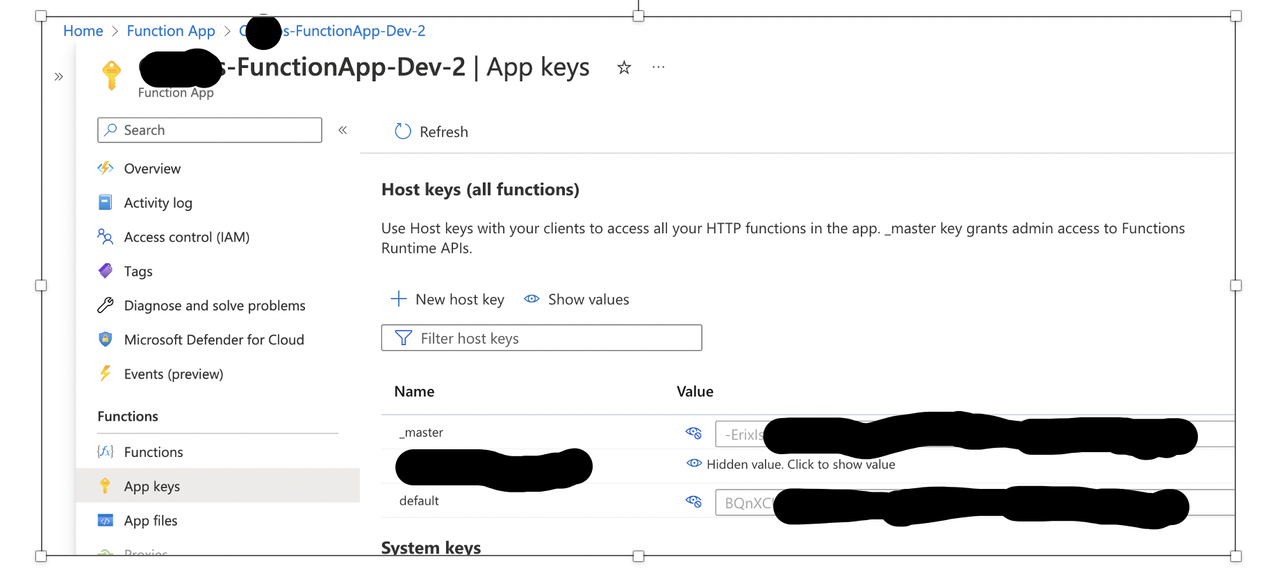

I am facing some weird issue from azure function app, i.e., the function app keys are getting changed too frequently (like i changed 20-30mins ago) and after sometimes when i make request to functions with valid key i'm getting 401. But this issue is not in PROD slot, only in QA slot
I have 2 environments DEV and STAGE in both i am facing the same issue, i have not done any modifications recently and moreover it was working perfectly few mins ago.

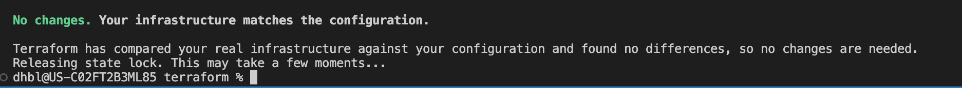

  • Tried checking changes from terraform plan, Showed no changes (Didn't work)

So please help me if anyone has faced this issue or any idea on this to resolve.Screenshot 2023-02-03 at 4.41.29 PM
Screenshot 2023-02-03 at 4.43.17 PM
