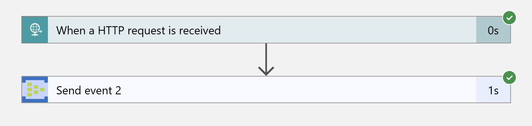

    Since you are not interested to write dot not code to send messages. You can consider creating a logic app for this purpose. Logic app has event hubs connector, in which we can send event action. Using this you can send messages to Event hub.
    Below screenshot for sample logic app.

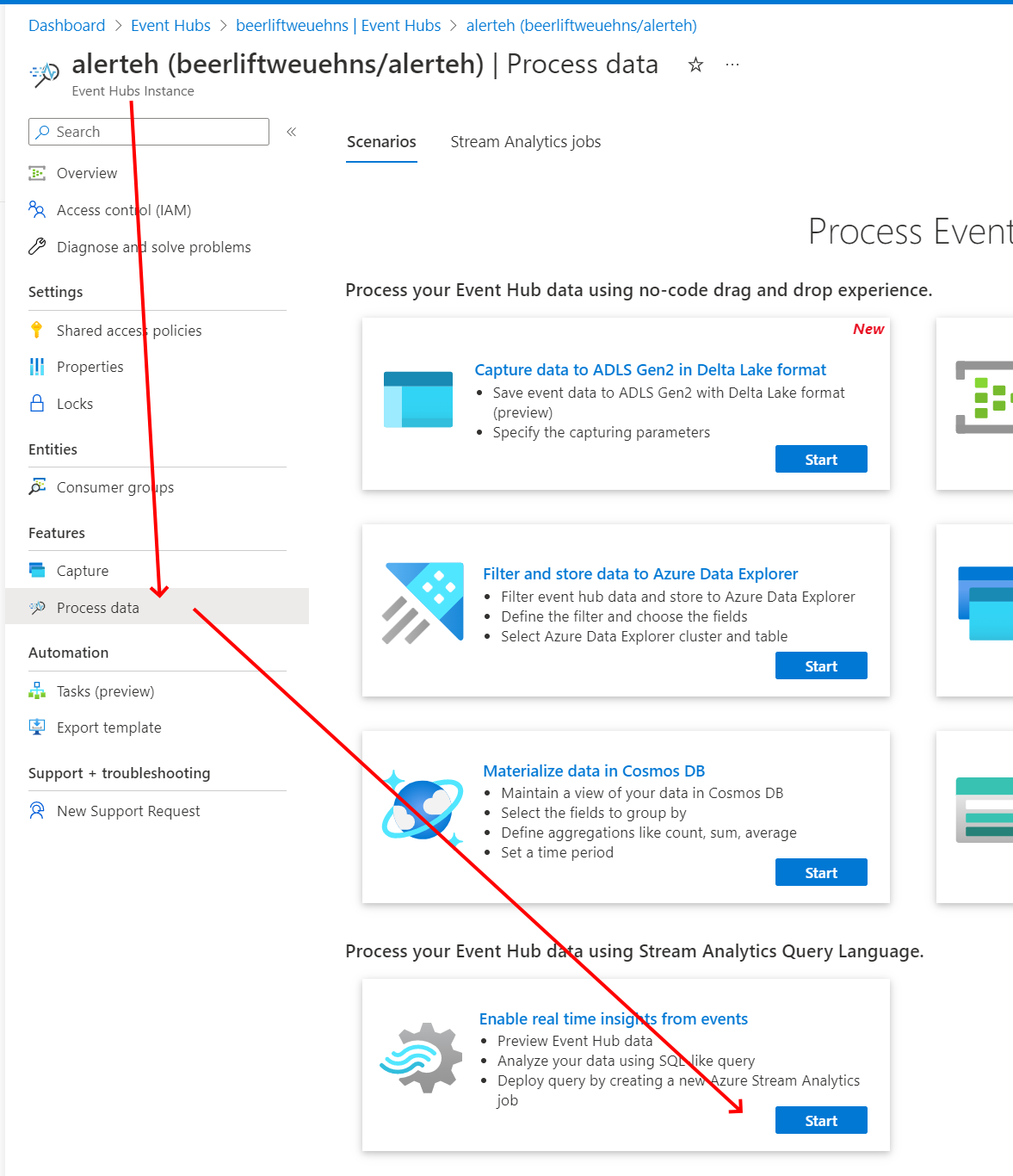

    To read the messages which received by event hub you can consider using Enable real time insights from events template under process data menu.

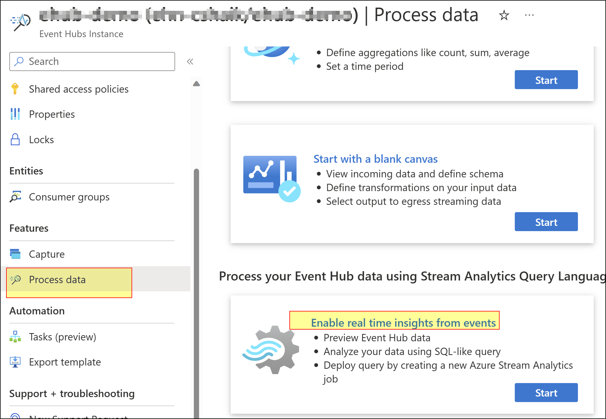

    You can see incoming messages in the portal using the 'real time insights' option:

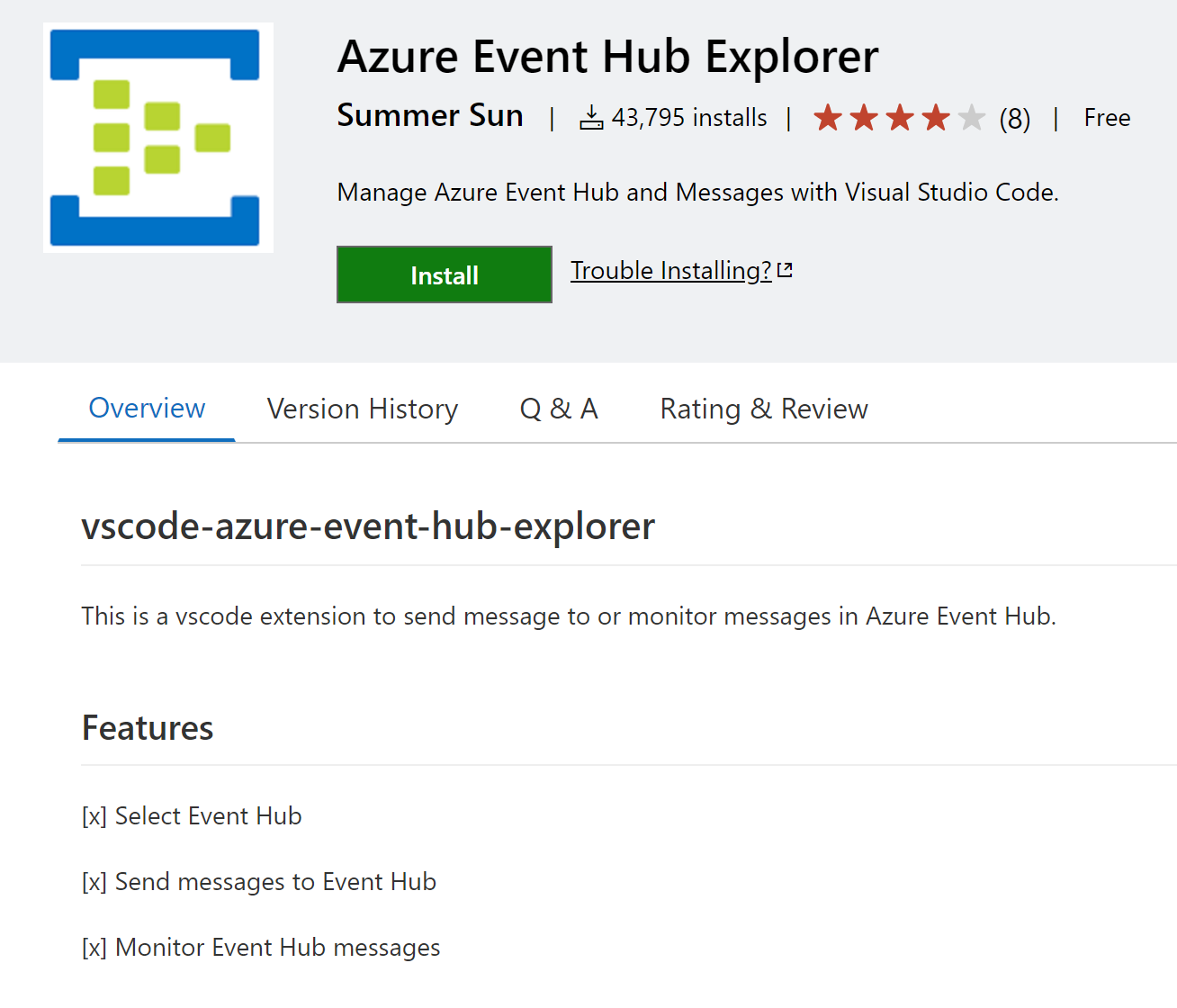

    Have you checked out this VS Code extension:
    Here is the Link to the extension.
